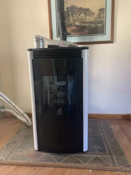

Hey everyone. Hope you are all having a great day. I just bought and installed a Hartman Allure50. My question is. This stove has a 3” air intake. My old stove only had a 2” air intake. What should I do ? I would like to get this up and running as soon as possible. I have a brick ranch so when I put the original hole in the brick for the air intake it was a lot of fun. Any suggestions would be appreciated. I have some vent pipe left over and think I could use that

Is it the hole like 5 miles away on the left side of the photo? Can you abandon that one and maybe go down through the floor with a proper sized hole?
Thanks everyone for your replies. So what I did was removed the old 2” air intake. Then I used the hammer drill with a drill bit and chisel and spyder bits to cut through the wood and cement board which are my walls then I got out to the outer brick. I then cut the hole 3 1/4” in diameter. Once I got the hole done I slid a 12” 3” in diameter duravent pipe through and sealed it all up. Only thing is it must not be 3” in the back of that stove for the air intake because when I put the 3” pipe onto the air intake in the back of the stove it was too big. So 2” is too small and 3” is too big. I used flexible aluminum duct pipe to connect to the stove back and then to my new pipe coming out of the wall. I had to use clamps around them to cinch them down but it’s on now. I’m letting the high heat silicone cure tonight and will give it a test run tomorrow. Once again thanks everyone.
