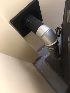

I have cleaned it several times even rewatched the cleaning video and made sure I wasn’t missing anything. I posted a sketch above of floor layout for basement and 1st floor. Any suggestions on were to put fans and push cold air? What temp is the surface of your stove normally. The exhaustcomes out of stove. 90’s up a foot ten 90’s out through the wall Straight to outside with end cap cover thing. Do you think I need to run it up higher on outside?

I noticed in the latest photo you posted of the back of your stove that the probe appears wound up and sitting right next to your stove. In fact, at second glance it looks to be an inch or so away from your exhaust pipe. That probe should be a bit away from your stove . I would suggest three maybe four feet at least. Other users put the probe even further away from the stove.
Depending upon what type of setting you're using, (room temp. or stove temp.) the probe is an extremely important part of the cycling up and down of your stove. If your probe is truly that close to the stove and/or exhaust pipe, it may never crank up as it's reading the temp. right around your stove and not out into the room itself.

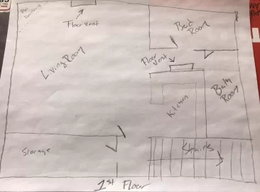

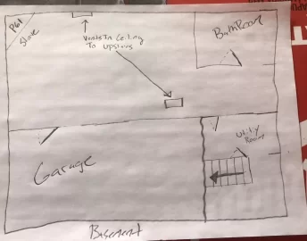

Where do you recommend i put it? Up on the wall behind stove?
I would place it out into the room about three feet high up your wall and maybe 3-4 feet away. Obviously you want to leave some slack on the line. It might look a bit weird hanging on the wall, but you can decorate around it somewhat. If it is truly right next to the exhaust, since that area is typically very warm from the exhaust and radiant heat coming off the stove, the probe is possibly telling your stove its reached whatever setting you have the heat controls on. However, it's obviously not that hot out in the room. Do you follow what I'm saying?
From the drawings, looks like basement steps come down in utility room? Put a fan somewhere between bottom of steps and doorway to room with pellet stove, blowing toward the stove. At the top of the steps, have a fan pushing the low cold air towards the top of the steps. From your third picture, looks like the room temp sensor is coiled up behind the stove next to the exhaust pipe. I'd uncoil it and put it on the wall, still behind the stove, but away from the exhaust/heat. See if that will help it running in room temp mode. Your exhaust looks fine. More rise in exhaust helps when the power goes out, keeps the smoke going up and out instead of into the room. Have you cleaned the esp probe in the exhaust? I use a paint brush taped to a paint stirring stick and brush it off, instead of pulling it out. I take stove temps on the front, up top of the door, between room fan outlets. Right now, it's on feed rate 2.5, room temp at 77 and fan @ 1/2. It's reading 385 degrees. When up around feed rate 4, room temp set around 78-80 I get close to 600 degrees with the Somersets.
Just placed fan at doorway or utility room pushing air towards stove room. You think another fan upstairs pushing down steps?
Correct that, room temp uses both probes, stove temp only the esp.
More so towards the steps. Place a little bit away from steps, coldest place you can find.
Off topic but you don't have a cleanout "T", the wall thimble should be of the same make as the vent piping, and 8" from the exterior wall doesn't meet code anywhere

Do you use fans to move air around? Above I posted some floor plan sketches any input is always appreciated
