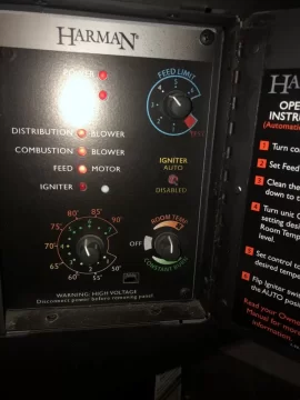

when you say small toggle you mean the ignition toggle? Like this?
Yes...On my stove it's labeled "Manual" rather than "Disabled" As you probably know, if left in disabled the stove never shuts down and will just idle when it reaches the set temperature. If you leave it on "Auto" the stove will shut down completely when it reaches the temp you have it set on and restart with a complete re-ignition when the stove senses the heat has dropped.
I prefer the disabled as it supposedly extends the life of your ignitor. Some, however, surmise that it burns more pellets than perhaps necessary when in disabled mode.
