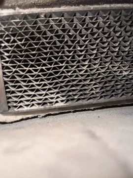

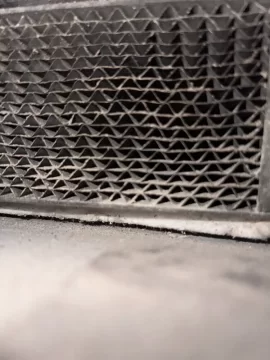

A new cat is going to run on the hot side. Try to keep it out of the too hot zone. The stones are slow to warm up.
The uneven burning sounds a bit odd. Is the firewood load biased toward the hotter side?

I try to load it pretty even but it does seem to always burn more on that one side. I’ll try to pay attention in the morning and load it even and see. Even the flames at the top always tend to be on that side also. I looked at the cats and they look normal to me. Nothing crazy. No visible damage or anything I can see. A94A2F4C-7BB6-4330-B069-B83D33DC764B.jpeg79BD72CD-8670-4C97-8A57-50A9CC23179C.jpeg

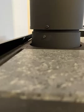

I have and door seems good. I did also light some egg carton and checked with smoke also. I have a double walled stove pipe and it does seem like the smoke is going in a bit at the back at this location where it joins with the stove and I do hear some air whooshing from this location. It was installed by the place I bought it.

If you have a leak there, it would affect overall draft and could be related to not reaching temperature on the stove. But if it's that severe that it affects overall draft, I'd also expect some smoke roll out upon reloading.
My gasket question was related to the uneven cat heating.
Is there another possibility for a leak somewhere? (I don't know these stoves, and if the stone is seeing fire and should seal, or whether there is a steel box inside).
