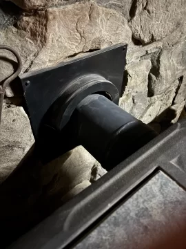

Setup of back of stove, which is where it smokes when windy.
Am I seeing like a 1" gap all the way around the pipe at the thimble? That would be enough to kill your draft right there.
Maybe quarter inch or so. Again—installed by chimney experts with a great reputation. I spent thousands on a new setup, knowing the liner was bad and the ceramic thimble cracked.
Now that I’m feeling it, the gap is really only at the top of the pipe. There is draft there though.
That doesn't mean it was done correctly unfortunately. This should be a tightly sealed fitting with no air leakage.
If any noticeable amount of air is pulling into the chimney, that's reducing the draft felt by the stove. Your old stove was probably easier breathing and didn't care as much.
Do you have some (non-combustible!) material like ceramic insulation you can stuff in there to block it off a bit and see if the stove performance improves. Not as a proper fix but as a test.

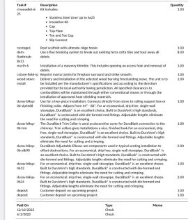

This is good info to have. Posting relining specs now.
I do believe the old ceramic thimble fit snugly. IF this is the issue, how much are we talking to fix? The stone backsplash is fieldstone from the family farm and I really wanted it touched as little as possible.
Yeah, afraid to do that. Already fear burning down my house.
You can fill that leaking joint with Stove and Gasket Cement from a local hardware store to prevent air leaking in, reducing draft. It is made for attaching door gasket material or putting together the multiple parts of cast iron stove joints. (No chance of that burning)
It may crack over time, but will prove there is not an issue with your stove.
What’s happening, is the hot exhaust gases rising up chimney creates a low pressure area, or vacuum in chimney flue, pipe, and stove. This pressure differential between inside and outside of chimney is measured as draft. This allows atmospheric air pressure to PUSH into stove intake, feeding the fire oxygen.
Like a vacuum cleaner with a leak in the hose, or a drinking straw with a hole in it, air is rushing into the void created by the chimney, reducing draft.
It depends what exactly is the problem. It looks like the thimble is a bigger size than the pipe, which would mean you need an adapter. However your invoice shows a 6" liner and this is a 6" stove so I'm not sure why the thimble would be oversized. I'm curious, if the chimney guys thought this was acceptable, what other wonky stuff could be going on behind that trim plate.
