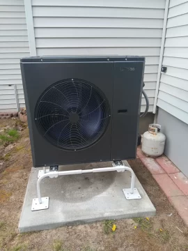

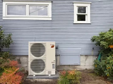

Rather than waiting for our 20 yr. old heat pump to give out the ghost, I gave our old system to a friend in need and put in a modern, commercial, Mitsubishi hyperheat system. This is for a ducted system. It's a nice improvement. Most of the time it's so quiet that you don't know it's running. I added a whole house surge protector while at it. Currently the system is loafing with mild temperatures. I am curious how it does when old man winter blows in. We'll still keep burning, but it will have to get colder before we do.
[Hearth.com] New heat pump for the season
Theoretically, the 3 ton system is rated to put out 40k BTUs at 17º. I will put it to the test when/if we drop into the low 20s to see how well it carries the load. The old 3T system was good down to about 30ºF.

I was considering the 4 ton version. This Mitsy is a 3 ton system, but combined with this particular air handler the capacity is raised a bit to 40K BTUS. The combo provides a better COP for heating which is the goal. There is a notable improvement in heat output at the registers already over our Am Std/Trane Heritage 16, 2-stage system.

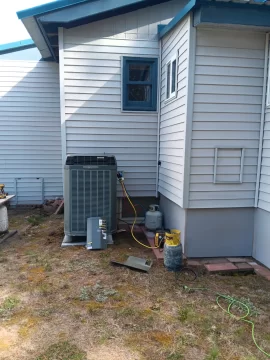

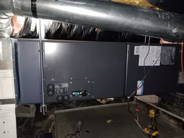

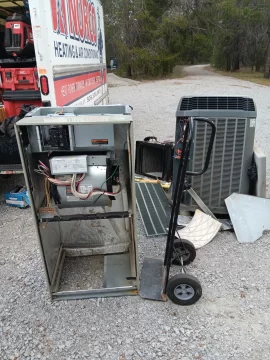

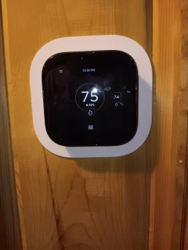

So far burned less than 1/3 of bag of pellets. Old Heat Pump was from 2002. Worked, but we only used it above 30f. Included pics of Old and New. Took 2 days to swap out. Learning Curve on Thermostat. Had it figured out and they updated it. Gives Weather Forecast on it now. Outside Temp and Indicator of Aux Heat. Downside you cannot tell the fan to run 100% on Heat. Just AC Mode.
