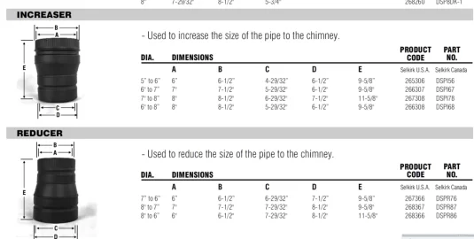

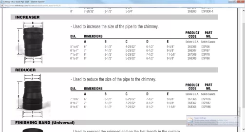

Check out their website for product catalogs. I've been doing some research. It looks like you'll possibly need an increaser. 6" to 8" is product # 266308.
That would work except it needs to be crimped on the 8" side to go int the wall. Ill keep looking.
Thanks!
They have an increaser or a reducer, it switches the crimp side. But I think the increaser does have the crimp on the 8" side:

That sure looks like it would work. Increaser/Reducer.....is it industry standard to go crimp towards stove or just a preference I wonder!
Thanks again, I couldn't see the skirt on the manual I downloaded.
I'm no expert, but I would GUESS the crimp goes towards the chimney. If you read the descriptions the Increaser says "Used to INCREASE the size of pipe TO the chimney", and the crimp is on the larger end. On the reducer the description says "Used to REDUCE the size of the pipe TO the chimney", and the crimp is on the smaller end. I'm just guessing here, maybe somebody with more knowledge will come along.
