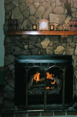

I have a 32'x32' four room cabin in the mountains of west central Pa and I heat it with an fireplace insert and a ventless propane wall mounted heater. I use the propane for a couple hours after we get there and by then the insert can handle it down to about 0 to 10 degrees any lower then I use the propane a little more. With the experience of this insert I would not make that choice nobut I do not want to make a change, my insert is only 2 years old and my wife did such nice work on the stone I would be in big trouble if I took it out . The camp next door has a vermont castings cat stove and he can cook you out.
