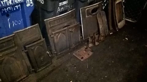

Ok, so here are the pics from the other night. Have not had a chance to take day time ones. There is some typical "surface" rust that happens with cast iron, so it is nothing crazy but I would like to try and get it to newish looking condition. Thank you

With a good wire brushing that will clean right up. Use a brush on a drill to speed things up. Then blow clean of all dust and wipe down with alcohol before painting. Use a good quality stove paint like Stove Brite metallic black and it will look like new.
