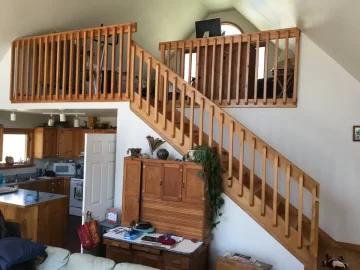

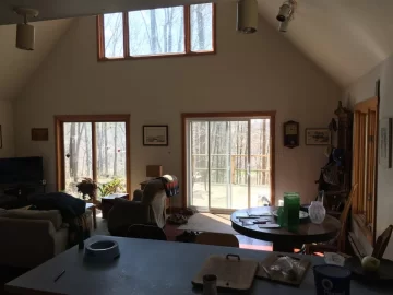

If these help, here are a couple of pics
Thanks again for any thoughts :)

There are many stoves that would work for this setup. I'd look for something in the ~2 cu ft range. If someone will be home to tend the fire every 6-10 hrs. then a non-cat would work. If not, then a cat stove may be a better choice. What's the budget and is there any style that is prefered?
