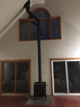

![[Hearth.com] New home, new setup, on the right track? [Hearth.com] New home, new setup, on the right track?](https://www.hearth.com/talk/data/attachments/216/216000-b04b21aa84497ffed782da2bbd52a239.jpg?hash=wKulX3NEaG)

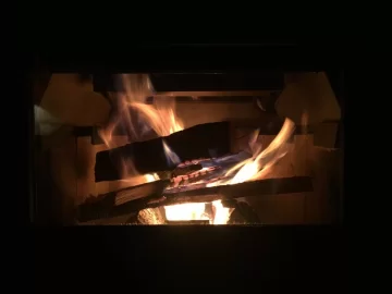

![[Hearth.com] New home, new setup, on the right track? [Hearth.com] New home, new setup, on the right track?](https://www.hearth.com/talk/data/attachments/216/216001-2e5a31b518906ab9a9709296046c4a86.jpg?hash=Cf-zNx-Z9g)
