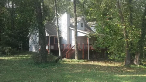

[Hearth.com] New home owner...lost in the sauce I have another question. Is it normal during heavy rain with wind to hear some water drilling down onto the stove body presumably from the chimney? My guess is maybe water splashed from the flat metal of the cap into the grated deal and some also came in sideways through the slits. Here is a photo of the house. I never saw any water, just heard drip.........drip on the metal during the heavy part of a rainstorm.
I'd say no, not normal to hear dripping water.
I have only had this happen once and that was with Metalbestos chimney. Took a while but the final solution was to run silicone up the seam of the length of the pipe passing through the storm collar.

To tack on another question...when it's very cold out, I note a faint cold draft coming in from the two vents under the stove. Is this simply due to a normal draft down the chimney, and cold air falling, or what? I have both levers in the "closed" position.
It could be the wind in just the right direction, a negative pressure caused by a fan running in the kitchen/bathroom, or even the atmosphere. All sorts of reasons. It should reverse when you light the stove. You may need to open a window a crack when lighting it if your house is tight. When your air is shut off completely, there is just a bit of play designed in so that a bit of air can still get to the fire.
Makes sense, and yes, when the fire is lit it goes the other way. In the lower vents, out the top (warm). House is extremely well insulated. You can't slam a door in it unless you crack a window, lol

OK. Assuming these doors open inwards, it sounds like your new house might have the "chimney effect" that is causing the cold air to draft down your flue. If the air inside is warmer than outside it is lighter and wants to escape from the higher reaches of the structure. If there is an upstairs window open, leaky windows, bathroom fan vent that is not sealed, light fixtures sucking room air into the attic/roof soffits, etc. it can depressurize your house. I think you might want to investigate and find out why your house is depressurized. If you solve it, your stove draft will improve, fires will be easier to light and your house will be cleaner, less smokey/dusty through the winter.

Look for leaky windows, bathroom fan vent that is not sealed, light fixtures sucking room air into the attic/roof soffits, etc. Basically, anywhere the perimeter is perforated high on the structure.

The Chimney Sweep inspected the cap, and the storm-collar looked good, but he drew another bead on top of the existing bead, anyways. He DID note, however, that the 4 screws which held the metal cap on at 4 covers were NOT sealed, and he drew a bead on top of each. The culprit, he feels, is a 1/8" hole where one of the screws was inserted through the cap, and then removed, as it was too near the center and was over "empty space", and then replaced to its corner. This hole was NOT sealed, and I am suspicious that this was the source of the dripping, as it is the right size and was in the right location to cause the symptoms I reported. I have not had enough of a rain since to truly verify this, however.
I have not found any real "leaks" in my house that I think would cause the draft. My best estimation is that since my fireplace chimney is a triple-wall type system, air currents are rising/falling through it, circulating, and a slight differential is caused.
