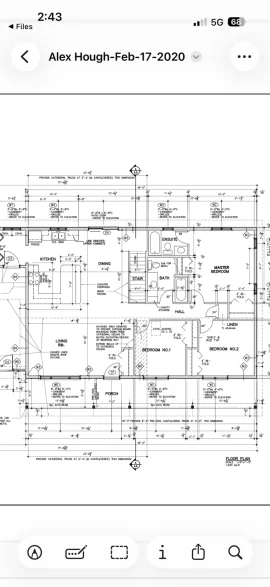

I would say there where you can keep the full flue inside the home. WOrks better. (less gases cooling on the way up, less deposits).
If you have a choice, I'd put it near (right across from?) the stairs. Heat can go up the stairs nicely then.
However, this works best if you are able to create a air flow circuit: get cold air to go to the basement *in a different place from where the warm air goes up*.
See this thread how I did it.
If you make a cold air return down to the basement on the outside wall between kitchen and living room , you get some good flow to that side of the home. But the other rooms will remain quite colder,
However, in general, it's not easy to heat a whole house with what is a space heater.

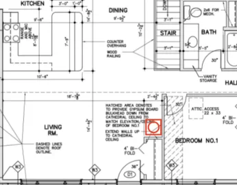

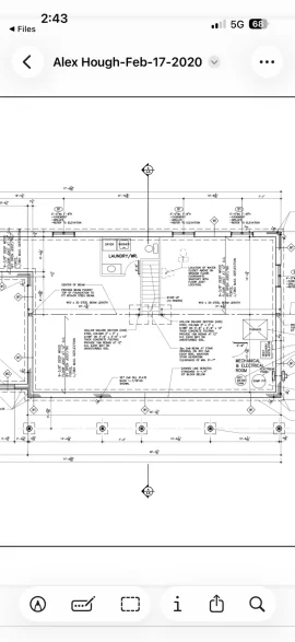

Is there an exterior entrance to the basement? If not, how does the wood get to the stove? Also, basement locations can often be a negative pressure zone. That can make installing a stove there a gamble. Definitely plan on an interior chimney up through the house and if possible an outside air supply to the stove for combustion air. Possible chase location here? Or better yet, put the stove there on the main floor.

Regarding outside air supply, these cannot go "up" but should end up at or below the location the air enters the stove.
So if outside grade is above the stove air inlet, that's an issue.
Also I see a furnace; unless they have their own air supply from outside, they can they suck and exhaust a lot of home air. This can lead to (more) negative pressure in the basement (see BG above).
Yes, that's a concern. There are no elevations showing grade. An outside air connection can be made if there is an air gap. Some stoves have this built-in to avoid the potential for reverse venting. Another important point, if the goal is to heat both floors, is that the basement walls (and ideally the floor too) need to be insulated.

And, is the basement insulated?

Yes, the basement will be insulated.
