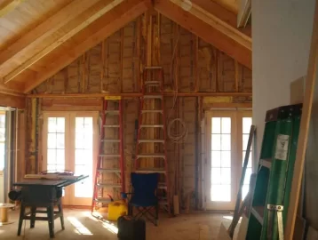

Here is a picture of the wall where the fireplace is going...

The 7100 is a lot of fireplace for the money, and its a great overall heater. I havent seen a bad firplace extr. product on the market, great reputation and a great product. . But one thing i know for shure is the 7100 cranks the heat and has a huge firebox.
That's my concern. In a new construction, well insulated house, this stove may be serious overkill and only usable with a low fire unless the windows are wide open. Maybe consider dropping down to the Xtrodinair Elite 33 or the Jotul Kenebec?
Also, if the outside chimney isn't boxed in yet, consider insulating it. The more you can make it act like an interior chimney the better it will behave. This will translate into easier starting and it will create less creosote meaning less cleaning.

As far as your chimney goes, i dont see a fireplace on that wall? why are you looking at inserts? according to that photo you should be looking at EPA zero clearance firepolaces. Im assuming thats what you need, and you dont need a insulated liner for a zc fireplace. You will install the pipe that the manufacture recomends for there unit. In the case of the quad, you would install heatilator sl300 or simpson duraplus 2100* chimney.
