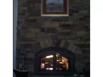

Here's a snapshot from tonight.
  • [Hearth.com] New house construction - reccommendations wanted for wood-burning insert -- 44 Elite?

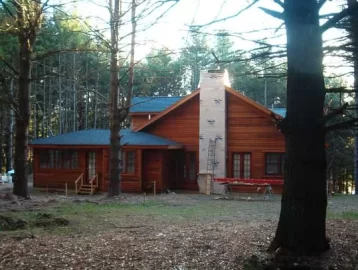

Hmmm. The new photo has me a little confused. I thought the stonework and flue for the stove was going to be exterior. But now it appears to be an interior chimney. If so, follow Elk's advice and do it by code.
BeGreen - I don't know the right terminology, but the fireplace unit will be half inside and half outside the house, the chase will be outside.

Gotcha, so the stonework on the interior is just a stone veneer. Then we're back to the original recommendation. Insulate the exterior chimney chase to increase draft and reduce creosote buildup.

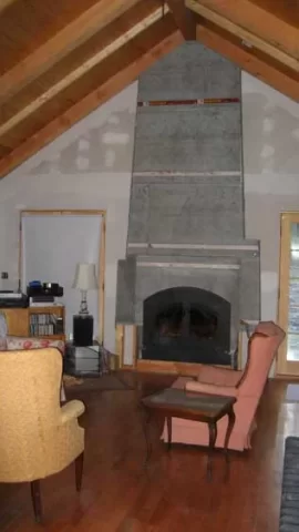

pictures...wish I could show you ones with the stome finished, but that may be another couple months at the rate we're going.
Looks like the house is coming along very nicely Mike. It's going to look super when it's all done. What type floors are they? Brazillian cherry?
How is the quality of the wood that's being burned? Is it nice an dry? Can you describe your burning process from start to finish? Include details about the starting kindling type, air regulation, when the air is reduced, etc. How does the smoke out of the chimney look when starting up, and after the stove is hot? Totally blackened glass after 5 burns doesn't sound right on a modern insert, but I haven't run one of these stove.
Hey BeGreen - the floor is a Bruce style available at home depot - it's a distressed maple that does look abit like brazilian cherry. (We actually got it during a 20% off sale that brought the price down to $5-something a sq ft).
