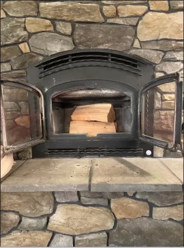

Hello everyone,
I'm trying to identify the brand and ideally model of the stove in my new home. I'd like to learn more about the controls and am hoping this will help.
On the front there are 3 controls.
In the middle below the handle is a slide the pulls out and then moves left <-> right and appears to lock the additional slide below it.
In the middle on the bottom is a slide that seems to control the intake air flow
On the right hand side is (I believe) a rotating outgoing flu control knob
Not pictured is a wall switch and fan control knob.
The main reason I'm trying to learn more is that there is a huge draft coming through the bottom of the stove/insert that I can't stop using any combination of the levers and knobs.
Thank you for any help and advice.

Typically If there’s a lot of draft around the fireplace, the chase was not insulated and/or there was no draft stop installed at ceiling height. We see it all the time.

Thanks, I will fiddle around with it a bit more. After getting the model information and looking at what you are supposed to do, I believe I was doing everything right so there might be extenuating circumstances as you say.
