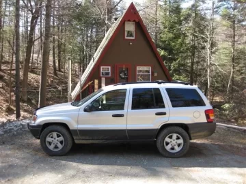

I'll get some pics for you guys this weekend. I actually may clean the chimney myself this weekend. They left behind a brush and a fiberglass pole. After some investigating, I found the cleanout at the bottom of the chimney. You should have seen the chunks of creosote at the top of the chimney cap. I'm starting to think they burned wet pine.

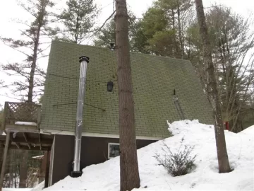

There's already piping inside the house....in the hearth area. I'll attach a pic I took from the outsie of the house back in February. Sorry, it's a bit blury. The other pic is of the chimney. It's got a few dents in it, but looks to be in good shape. Again, I'll get some better ones this weekend.

The flue looks marginal both in height and distance from the roof. How tall is it above the tee? How far is it from the roof, 2 ft below the cap?
For good draft, most stove companies want ~15' flue on their stoves. As a cold exterior chimney it is going to condense creosote gases quickly. FWIW, this would be a far better installation if the flue was run up inside the cabin.
As it is, the connector pipe will be minimal. Given the short, cold flue, I'd use a 45 elbow + connector + 45 elbow connected to the thimble to minimize resistance and assist draft. For the least fussy startups and reloads, you'll want a stove that drafts easily and for a corner installation, one with close corner clearances. You might check to see if there is a Napoleon stove dealer in your area. A model 1400 will meet these needs. It drafts easily and if double-wall connector is used, it requires only 4" corner clearances.

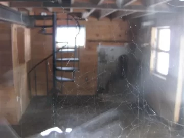

Here's a better pic of the roof and pipe. I had moved the Jeep in order to use my miter saw in the driveway and snapped a pic.
Is the "T" the area where the pipe goes from horizontal from vertical? I can easily measure that this weekend. I will also take better pics of the inside connector, and the "homebrew" setup they have for a concrete pad and stone hearth.
Our home inspector commented on the height of the pipe. He said that some installers may try to sell us on raising the height of it because it's not above the roofline. He felt that wasn't necessary and thought that the way it was set up, the roof would actually help buffer any potential downdrafts. He mentioned that insulated pipe can get a bit spendy.
If you look very closely at the pic I posted, you can see the old pipe on the ridge of the roof. Best we can tell, they used to have it set up to vent that way. As it is now, I don't think that's an option. There's just not enough space on the main floor to run piping...or a chimney structure.

Wow, that pipe actually looks WAY to short, and i am not sure how the inpector thinks that the house will help with down drafts. The wind will come off that peak, create a negative presure pocket over the cap, and down the smoke will go.
here is a bit on the 10/2/3 rule
This rule is frequently misunderstood or ignored, and many people have drafting problems with their fireplaces for this reason. This rule is fairly simple, however, and must be followed in every vented fireplace installation.
National Fuel Gas Code, ANSI Z223.1, Section 10.5.2.1, states the rule: "A chimney for residential-type or low-heat gas utilization equipment shall extend at least 3 ft. (0.9 m) above the highest point where it passes through a roof of a building and at least 2 ft. (0.6 m) higher than any portion of a building within a horizontal distance of 10 ft. (3 m)."
The basic rule is this: the bottom of the vent termination must clear the roof penetration point (the upper edge) by at least 3 feet; further, the bottom of any fireplace vent termination must clear anything within a 10 foot radius by at least 2 feet. This includes: the peak of the house, parapet, dormer, chimney or spire.

On a different note, im not sure that the chimney will work at the proper hight, considering how much chimney you will have exposed. I also dont think it will work in the current configuration, is it possible that the reason the stove is no longer there is becasue the stove didnt work? Have you tried do a smoke test on it with a smoke stick?

A few more notes about this., it is still very possible that extending the chinney will not work becasue if the condensation that will form from the long exposed run of pipe. Also, if you did extend it, how will you clean it? Its almost guarenteed that with a new stove and that much pipe exposed you are going to foul the cap durning the break in process, you need a good plan on how to attack a chimney that is that hard to get to. You cant really lay a ladder up against the chimney, and you sure as hell cant stand on the roof with the 10/2 rule with the pitch that you have. Im guessing that you will need to figure out a way to keep that pipe inside the house , and penetrate the roof near the peak so you or a pro can get up there and clean it. It will obviously make the stove work properly, but it will also allow the stove to be serviced.
Luckily, there's a cleanout at the base of the pipe. If you look closely at the first pic (the one that highlights the natural "mossy green" tint of the shingles, HA!) you can see the pipe is sitting on what looks like a metal shelf. Under that shelf, there's a cleanout. I'm assuming that the chimney is cleaned by removing that cleanout and sending the brush up the pipe.

I'd consider disassembling the current setup and recycling parts of it to an interior flue setup. It's little wonder that you found a large creosote accumulation. This is a problem installation from the get go.
If this is a known brand stainless pipe, you may still be able to get the parts to make is work on the interior. Once on the interior you can switch to double-wall connector which is less costly than exterior class A and has a modest 6" clearance requirement. Yes, this will take planning, but in the final result you will have a safer, cleaner and much better operating system.
