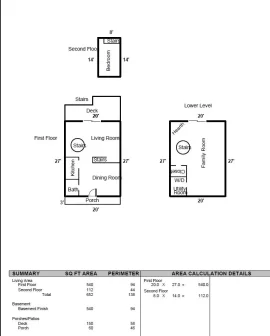

Good plan, take a look at the options and look at some stoves. If you can post some floor layout diagrams that include openings and stairwells, we may be able to help with a relocation of the stove. Can you see where they used to have the stove when it was connected to the central flue?
It's hard to tell how the old stove was set up. It was somewhere in the exact center of the house; based on that old pipe sticking out of the top of the ridge. There's a roughly 2.5' x 2.5' area of the main floor that's different from the rest of the floor. From the area below, it looks like that added joists/supports when that was covered up. I'm not sure if the stove/fire place was on the main level or lower level. I almost want to say main level because there are no indications that the stove was in the lower level; all the linoleum is there an non if it is marred or dented. Currently, the staircase that leads to the loft and the pantry would prevent anything from being installed there. The house was built in 1966(ish) so it's really hard to tell what the original set up looked like. My assumption (we know what they say about "assuming") is they had a metal fireplace; one of those round metal mid/late 60's models on the main level. Again, a total assumption or guess on my part.
Here's a pic of the floor plan I was able to take from one of the documents we have. This is the way the house is currently set up. The stove would go in the area labeled "hearth" on the lower level. That's the same area the current pipe is located.
Edit: Make sure you scroll down or click the mouse wheel for the dimensions. I didn't get a side bar when I viewed the image full size from this post.

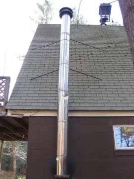

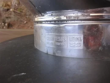

Pics as promised! I took a shot of the make/brand of the chimney pipe.
I also took another shot of the entire pipe. I did a little measuring/estimating. I'd say the pipe is between 12-14' feet tall. I was able to remove some creasote from the cap by standing on the deck and using an old chimney brush they had left behind.

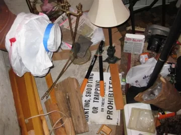

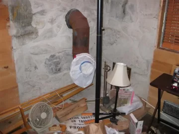

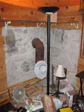

A few pics of the hearth. Remember, we moved in about a month ago..hence "stuff" everywhere. This is my tool "staging area" if you will. HA! But these should give you a good idea of how it's set up. They went a bit heavy witht the grount between the stones. I was able to clean one stone off with a stiff bristle brush.
Oh, one more thing to add...Our downstairs door is only 29" wide. There's a spiral stiarcase leading upstairs, and that's no fun for hauling bulky items.

pass thru wall does not look too cool.. no airspace around the pipe, just mortar, and the chimney is dented, and of a very old metalbestos variety. in some respects, this is good, it is probably asbestos in that pipe, so itll never burn out! otherwise, alot of insurance guys would tell you no way!

How old would you that pipe is summit?
Metalbestos is a name Selkirk uses for it's Class A pipe. It has nothing to do with having asbestos in the pipe. This pipe is currently available and is a high quality class A pipe, similar to Dura Vent.

the old stuff used asbestos lining, the new stuff uses mineral wool. depends on how old that chimney is, how old is the structure? did they reuse old pipe when they put it in?

i install the metalbestos pipe, as well as some others (icc, duravent) and it is a very solid pipe.

It's hard to say how old the set up is. It's not the orginal setup they had; which appears to be a center chimney at the peak of the roof. This side chimney through the foundation was added at a later date.
I know the stove place is going to balk at the set up. I did read the manual for the Castine and it looks like we just barely have the min height for the chimney of 14'. Now the only hurdle is it clearning the roof peak. We just don't have the funds to completely redo the chimney and hook it up to the old ridge mounted unit. That would require a lot of work inside the house.
