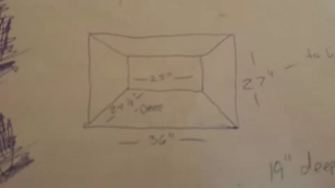

I am in the search of a insert. It's to supplement my basement stove. The local retailer sells PE, Regency, Enviro and BK. Both stoves will be heating over 1000sqft . This is the measurement any ideas which stove would work

You have good choices. They're all good stove companies with good products.
Not sure about those, but the Buck 91 would fit in there, although it would be snug on the height, and tough to connect the liner. I agree with bg, those are some good brands...go to their websites and get the manuals, they specify fireplace minimum dimensions...
That's plenty of room to fit pretty much any insert in there. If it only needs to heat 1000 sqft something ~2 cu ft should be sufficient. PE Super/T5 would be a good choice as well as Regency F2300. BlazeKing Princess when you want longer burn times and more even heat output. Enviro 1200 series will be enough for supplemental heat but you may not get quite an overnight burn. The 1700 series would also be ok although it is possible that you will rarely fill it up.
