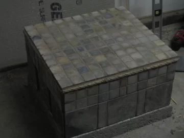

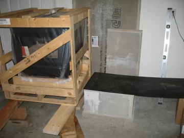

I picked the best spot I could for space and cut a hole, enlarged it for clearance, enlarged it again, built an insulation barrier, made it taller, built a level base for the stove, partially tiled it, and hooked it all up.

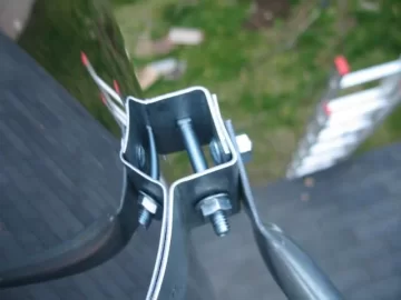

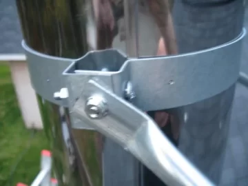

It took me a minute to bend the Roof Brace kit bands the correct way and attach it. I included some pics for the next clumsy Do-it-yourselfer that can't find a picture on the internet. The local dealer was very helpful explaining how to hook up the chimney, so I didn't mind buying the whole package from him.

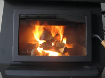

More pics, the selkirk Roof Brace Kit, and first fire--Alaskan Yellow Cedar from a brother in Ketchikan.

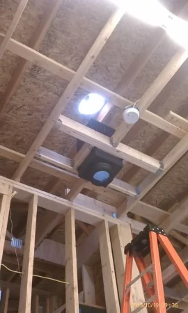

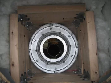

The chimney going through wood looks incorrect. But maybe all is not showing. What are the details for the chimney? What is the chimney pipe being used that allows zero clearance to wood combustibles?
I though that to i think it might be a round support box if not and that is the pipe there are some major problems
Yes, I can't tell from the picture what is actually installed and providing clearances. Need more info.
That's looking down thru the ceiling support. You can see screws thru it into the framing. Though it should have a proper insulation shield.
Thanks Jeff, now it makes visual sense.

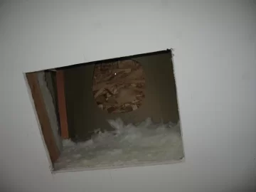

Chimney goes through ceiling and roof too close to eaves to fit an attic insulation kit. Seller said build a frame of plywood or dimensional that was at least two inches clearance to keep the insulation back.
The Ultra Temp goes through that box. Should I change it around and try to add a different insulation shield? Thanks guys.
The only purpose of that attic insulation shield is to hold stuff two inches from the class A. It can be made of wood. The requirement is met with wood or metal. I am more worried about the funky brackets you used in the structural locations to support the weight of your chimney. Did you verify their adequacy? Typically you would use a joist hanger.

The insulation shield also keeps stuff from falling in around the pipe. If it is enclosed in a chase, it should go all the way up.
+1 on the joist hangers.
Reactions: BenBurns
The ceiling support box should be what is supporting the weight of the chimney. Hopefully the bottom 2x4s are tied into the joists. Can't tell from the picture.
The bottom 2x6s are using just the funky brackets with simpson bolts. I will reinforce that. It's easy enough to take the chimney back out since it's relatively clean and I haven't finished the ceiling yet. Oh, and the bottom ones are tied in and butted up, but not with hangers. Just the top layer is really weak looking.
Will post pics in a week or two. Not using the stove as it's still kinda warm here. Thanks again.
The bottom 2x6 should tie into and box in the space between the adjacent joists. You'll want solid support on at least two opposing sides of the support box.
