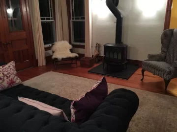

Just thought I'd update this thread--yesterday I had the stove installed. 1/2" Micore base with 1" honed granite hearth. Stove is the Jotul F400 Castine in blueblack enamel.
[Hearth.com] New Install - Hearth Help
One issue: after install, I discovered a couple small chips in the enamel, which were definitely not caused by the install. Reached out to the dealer and awaiting a response. Any idea what I can expect? A new replacement stove? Significant refund and touchup paint?
