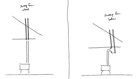

What installation techniques are available so I don't need to walk on my roof every time I sweep the chimney? This is a interior installation through a unoccupied attic. I think this sketch is what begreen was asking for... In the sketch on the right, I don't care for the looks, cost or complexity of the T fitting. I'd rather have the straight pipe on the left. However, once everything is put together, I'm not sure if it could be disassembled for cleaning. I'm also not comfortable with having the sweepings fall into the stove on top of the catalytic combuster.

Forget the tee. Instead factor ina slip joint in the connector pipe. That way you slip it up out ot the way enough to get a brush in and place a plastic bag under to collect the ash
Bingo! Right on Elk. Thanks for the post Cord. A picture is worth a thousand words. Go to the Duravent site to see a slip joint connector pipe. It's what we have on our stove.
