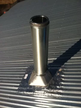

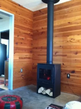

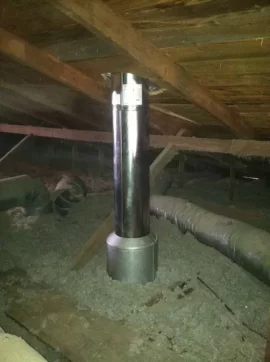

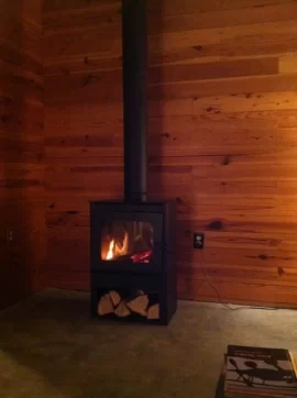

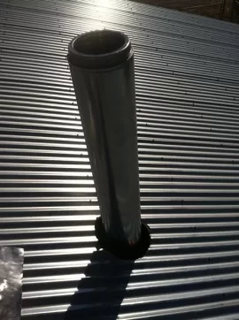

We spent the weekend installing our well-researched Englander 17-vl with Metalbest double wall interior pipe, round support box, attic insulation shield, and class A up through the roof. Installation was surprisingly easy. We ended up with a 13.25 foot chimney from the top of the stove (they recommend 15 foot) but it's well above the ridgeline of the house and it seems to be burning fine.
Clearance is 8 inches from the back wall (as spec'ed by the manual), and we're a bit nervous that the wood wall might discolor; does anyone have experience with this?
Final of three break-in burns was completed this morning, and we can't wait to have it humming along. We're in west Texas -- it's cold in the winter here, and we're hoping to phase out the gas furnace.
Other than everything going normally, are there any tests we should run to see if all is installed correctly? We're super pleased with its performance so far (three fires!).
One other question: the chimney cap did not come with a spark arrestor. I'm assuming we should get one since we are in a dry area; is there any reason we would not want one?

the installation looks beautiful however i see a MAJOR flaw! it appears this stove is sitting directly on a carpeted floor. if so this is not correct. the unit MUST have a floor protector with an "R" factor of 0.5 extending 8 inches from each side, and the rear , and at least 16 inches in front of the unit.

The stove is sitting on concrete slab floor (may look like carpet in the photo but it is concrete). And the install pics do not show the chimney cap; there is a cap on the flue, just no spark arrestor screen. We will definitely add the screen.

ohh ok, geez, it looked like carpet had me fooled, in that case forget i mentioned it. as for the cap, didnt know if iot had one the pic's didnt show it (mea culpa on the floor protector, i honestly didnt think it was concrete looking at it)

Sweet install of a sweet stove. Hope is does well for you. Burn dry wood and you folks should be very happy. It may work ok with the ~14' of chimney. Have you checked to assert that the chimney top is tall enough to be 2 ft higher than the nearest roof section? It's hard to see from the picture what's upslope of the chimney. If not, it will need some more pipe and a roof brace at the 5ft level.
The manual calls for 8 - 10 inch clearance on the back of the stove. Your picture looks like you have less than 6 inches to the wood wall....or I may be wrong....

Sorry I didn't see your original post for 8 inches clearance on the back. It looks a lot closer than 8 inch (with the stove depth = 12.5") in the picture.
I'd rather put something between the stove and the wall just in case. May be you can buy a hearth pad and put it against the wall on the back. Other members will probably have better suggestion than mine...
I am a born and bred West Texas boy. With the constant wind there put a cap on that pipe and it will draft live a Hoover. 3/4" mesh screen is a good idea. Scrub brush burns hot and fast if you aren't in town. Saint Augustine not so much.

There was a storm collar installed around the pipe over the roof flashing I assume?
Thanks for the responses. We went for this stove primarily for the looks -- it's a nice minimal clean almost European look, and with our small house it fits very well.
To speak to issues of the chimney pipe, we do indeed have a storm collar and a chimney cap. That west texas wind was blowing hard when we were on the roof, so we didn't get the final pics of glory. The pipe is indeed well above the ridge line, about 2.5 feet, so well-adhered to the 10-3-2 rule.

And we do have exactly 8 inch clearance on the back, which is allowed with double wall pipe. I am nervous about that wood wall... what should the max temperature be on the wall? We are armed with our new IR.
If there is any advice on how to load this firebox, I am open to suggestion. It's difficult to stack NS in it, but this being my first woodstove, I'm not entirely sure how to load it up.
If the wall temps stay below about 150F they are fine. This stove is definitely an E/W loader. For starting a fire, place a couple 2" x 10" sleeper logs on the floor of the firebox. Then proceed to load. E/W. The sleepers will allow air to get under the load for quick ignition.
Not positive but it looks like it might be this:
(broken link removed to http://www.woodstovepro.com/store/Selkirk-MetalBest-6-Ultra-Temp-Dead-Soft-Base-Flashing-2-6-6T-AF6D-p18413.html)
Thanks for the quick reply. That flashing does look pretty close. Just trying to decide which flashing is best for my new install going threw metal roof.
Depends the type of metal roof. Is it corrugated or standing seam?
Corrugated. I'm using duratech chimney pipe. I figure all the dsa flashing works about the same. I guess I should just use duratech flashing. It will probably fit my pipe better.
I like Duravent flashing, but have not worked with their DSA product. Duratech is good pipe.
