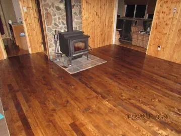

Welcome Jigger. Where are you located? Its -19 c here and we are warm inside our 2600 sq ft house despite the storm raging outside. My set up looks like yours. I wish I had stayed away from the ash pan as its a pita. Ive since shimmed it closed and packed it full of ash. How far from dry wall was it installed, 4 inches? What was your last stove? Since you have had it installed Im sure you know that this is a good stove with long burn times for a non cat. Enjoy!

We are in the Rockies in south eastern BC. My stove clearance is 4 inches as well. Our basement is half below grade and is fully finished with the stove in our rec room. Downstairs comprises of our rec room, office, laundry room, 3 piece bathroom, daughters bedroom, spare bedroom and office. Its colder downstairs in July and August then it is during our winters! I use my IR always and yes I turn it down on almost every occasion otherwise I reach temps that arent safe for the stove. These stoves run hot and can get over 750 stove top at the collar even with the air turned down. I love Birch and have a bit of it but burn mostly Lodgepole pine during the day and then Larch and a small amount of Birch for my overnight burns. Larch is almost the same as Birch but without the rot factor. The top down fire is awesome for getting a quick flue temp especially during mild weather. At -15 c you shouldnt have draft issues but are likely experiencing break in stove issues. Each higher temp will result in some smoke and fumes in the house.

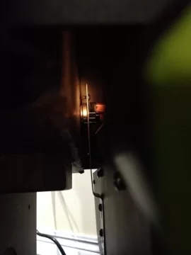

Here's a couple of photos of chimney install. The smoke was a result of cutting it back to quick before I went outside to shovel. I came back in and very little flame so opened up the air and she is cruising again. I put 3 splits this morning. it ran for 8 1/2 hours bed of coals stove top 220f. NG furnace was on but not to concerned at this point. Still braking in and my blower is on back order so moving with fans. One in corner opposition wall of stove pointing towards stove. One at top of stairs pointed down stairs. 28c (84f) basement and 21c (72f) upstairs. Likely 19c (67f) in back room which is great for sleeping.(broken image removed)(broken image removed)(broken image removed)(broken image removed)
