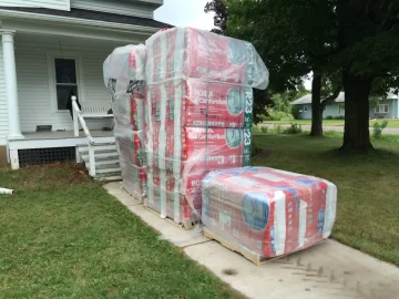

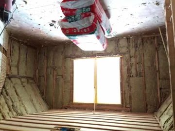

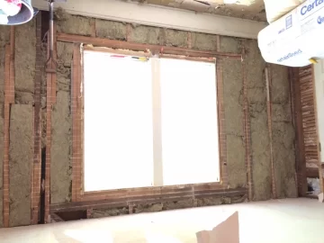

havent posted on here in a while, but my house gut/rehab has been going pretty slow, but this summer we did put in new insulation. The house has 2x6 walls so i bought roxul comfort batts that have an R value of 24, and the siding we have is insulated with an R value of 4, and with sealing up all the air gaps, cracks, gaps between boards, all around windows and doors with great stuff foam spray and a layer of drywall thats probably an R value of 1, so im hoping that our walls will now have an r value of around 28/29, which will hopefully keep us toasty warm up in zone 4.

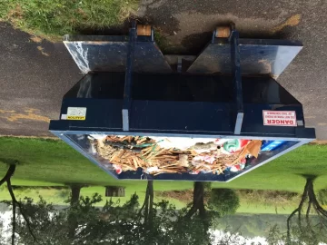

sorry some of the images are upside down...
