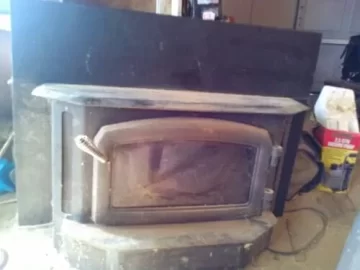

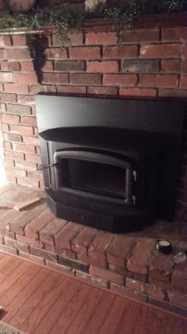

Saw a Regency i2400 pop up on CL. It was in bad shape. Exactly what I was looking for. After a few weekends refinishing it, looked as good as new. Next was the 6'' insulated liner, 25'. After reading positive reviews, I went with Rockford and OTD paid $720. After doing some lengthly reading, I determined the liner was a DIY job. I surprisingly installed the liner completely myself. That made it difficult.
Just wanted to show some before and after pictures of the stove.

Welcome Kevin. Nice job, the stove looks great. Was it just neglected on the exterior or did you have to do interior firebox repairs as well?
Is this an interior or exterior chimney? If interior, I would try it out for a season. Interior chimneys can release the heat back into the house. If exterior then block off plate can help keep the heat down at the stove where you want it. Tell us more about why it was so hard to connect the insert. 6" is not the worst working space.
Welcome. You did a beautiful job refinishing that old insert.
looks nice! do the inside too?
Super nice job!
