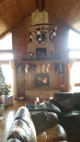

Here is where it will live...whiteout conditions currently in the background....

Does that unit have an option for solid insulated chimney? I would go that route if possible.
Make sure there is a draft stop at the lower ceiling level and that the exterior walls are insulated properly. This is often overlooked, even on new highly efficient homes.

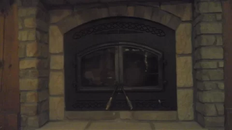

Well done my friend. It looks great. Fire it up and get warm. Something tells me the install cost a bit more than the insert.

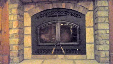

I lightened up your picture a bit so we can see it better.

Thanks for the pic begreen... and you are correct...install was a bit...bout $3000 total...I think that's a good price since the Constitution was sooooo cheap and basically brand new...it is in fine working order.
I have very seasoned wood, and an excellent draft. Cut air down once it's roaring and get beautiful wispy secondaries.

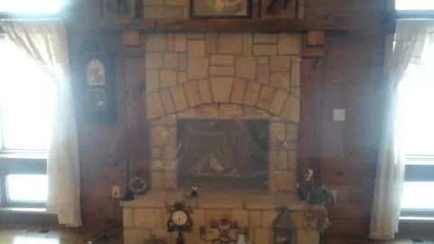

That is a great deal overall. Glad it worked out well. If you get a chance on a bright day to take a full fireplace shot from further back I'd love to see the whole picture of this install.
