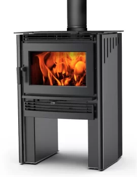

what about the Alberni?
begreen
Mooderator
Staff member
Nov 18, 2005
102,606
South Puget Sound, WA
I think that is a variation on the Neo 2.5, but seems to be only sold down under.
