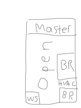

I have a (2007) manufactured home in northern Illinois, mostly open floor plan. I am planning on installing a wood stove in the family room on one side of the house (I have attached a drawing).
The open section of the house is ~1400 square feet. The rest of the rooms combined are ~1000 square feet. The HVAC return sucks directly off the room which the wood stove would be in.
I am debating between a drolet 1800 or 2100 escape. The 1800 is rated at 75,000 btu peak and a 2.4 ft3 firebox. The 2100 is rated at 110,000 but peak and 3.5 ft3 firebox.
I like the appeal of having the larger wood stove when I need it in the dead of winter but am concerned with overheating the space in the fall/spring. Any thoughts?

Both are very popular stoves, though the 2100 is much larger. Drolet makes a good quality no-nonsense stove. Enerzone and Osburn have the same fireboxes with a bit more features.
How well insulated is the home? (2x4 or 2x6 walls?) Is there a large amount of glass? High ceilings?
Note that the hvac return must be at least 10' from the woodstove according to mechanical code.
With my budget, I don’t need any fancy features, just need something of good quality that will last for a long time. Drolet sounds right up my alley.
Ceilings are flat, 8 feet tall. Pretty well insulated and tight home. Average amount of windows (all double pane) and my exposure is south facing.
HVAC return is 15 feet away from the stove. Also, the propane furnace is rated at 72,000 btu furnace. It does a pretty good job heating the house but when it drops to below -10 it struggles keeping up (thankfully we don’t reach those temps often).
We typically use ~1,000 gallons of propane per year. That is with keeping the house at 70 degrees. The wife would prefer 78-80.
I would suggest the larger stove. Can always make a smaller fire in a bigger stove, cant do the opposite.
I was going to order the 1800 and found it on amazon for about $1200 shipped.
Several local shops quoted about $1500 for chimney, and the only price for install I've gotten was $2000~2500 INCLUDING the chimney hardware. Hope this helps.
Thanks for the numbers. Those seem more reasonable than the quote I got. They wanted $4,000 for pipe + install without the stove.
That makes sense, but I don’t have much softwood. My property is mostly red oak and maple with about 5% softwood.
To me that says the 1800 would have been a good fit on all but the very coldest days of the year.
With the 2100 I think you will get good at building small fires in a large stove..."log cabin style" fires work well.

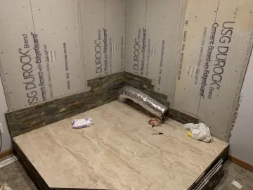

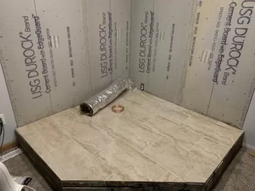

I am doing a corner install, double wall pipe inside (manufactured home). I am planning out my hearth and backsplash. I will be doing Durock cement board covered with ceramic tile for both hearth and backsplash. The hearth is required to be noncombustible only so I don’t need to worry about an R value.
The C/F values in the manual are distances to a combustible. Does the cement board/tile depth count since they are considered non-combustible? I.E. if my cement board/tile is 3” thick, does that mean the stove could be 7” away from the face of the tile?
In determining the distance in front of the door for the hearth pad, does the 16” required refer to the outside edge of the door or the handle attached to the door? I.E. is my stove depth for purposes of the hearth 24 and 1/8 inch or 31 and 7/8”?
The C/F clearance values are distance to combustible materials. Just measure the distances from the stove pipe and stove corner to the first materials that are combustible to find your clearance.
Use the door face, not the handle.

I received my stove a few days ago and am moving forward with hearth install.

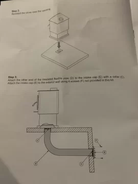

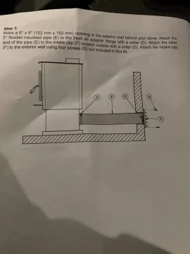

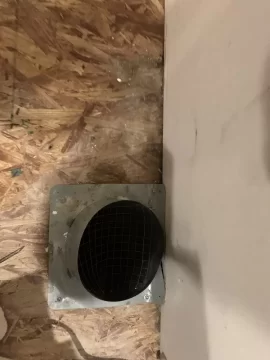

For the required outside air intake connection to the stove, I have a question about what is allowed.
The manual states it is acceptable to draw combustion air from outside through a wall or a vented crawl space. I have a pre-existing fresh air intake near the wood stove from my vented crawl space (see attached picture). My original plan was to route the insulated intake pipe from the existing opening under my hearth pad and have it come out an opening at the back of the hearth pad and run it to the stove intake.
However, the manual for the air intake only mentions two methods:
1. through wall and to the rear of the stove
2. Through the crawl space and underneath the pedestal (my stove manual specifically mentions this one is not approved)
Essentially, I am wondering if I can run the insulated intake pipe from the existing crawl space opening to the rear of the stove. (A combination of both step 3 in the attached manual pictures). (This would save me from having to cut a whole in the exterior wall).

Yes, you can.

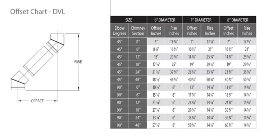

Piping questions:
1. Is it okay to use existing roof flashing from previous fireplace. My concern is it is 13” diameter opening while the one from duratech is 10.75” diameter. I don’t want there to be so much spacing that the storm collar isn’t effective.
2. The manual states a minimum 12’ chimney measures from the top of the stove. I am thinking of ordering two five foot exterior pieces and the stove pipe will be ~4 feet. So I’ll have ~14 feet chimney. I will need to put in two 45 degree elbows to account for an offset. Should the 14 feet be enough to overcome the disadvantage of the offset or should I add more exterior length?
3. Back to the 45 degree elbows, I have read a couple of places that the maximum allowed angle in the USA is 30 degrees. But I can only find duratech DVL in 45 degree elbows. Why the discrepancy?
4. Anything I should do with the piping system to make cleaning it easier? I would prefer to use a sooteater or similar product to clean from the inside of the house, if possible.
The old flashing is too large. It should be replaced with the proper sized one. I had a thought about splicing on the cone from the proper sized flashing to the existing one, but have never seen this done. Maybe someone else has.
I'd go ahead and try it with the 14'. It may work ok.
30º elbow is the limit for chimney pipe. Double-wall DVL stovepipe is a different animal entirely. It is only for interior use. They only make 45ºs and 90s for that system. Use their offset table to calculate the offset.

Makes sense, the articles I read weren’t specific enough about the 30 degree max being for chimney pipe instead of stove pipe.

You can get adjustable DVL elbows now, so you don't have to use 45 degree.

It has been a while since I posted. I am making progress (slowly) and will be finishing up tile work in the next few days.
