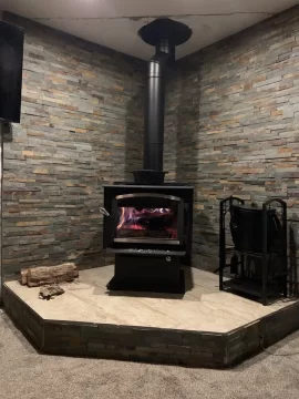

Wood stove was installed today and first fire is going!
![[Hearth.com] New member - new install [Hearth.com] New member - new install](https://www.hearth.com/talk/data/attachments/271/271626-6dd3e407fe31ec371b20034a8add44f3.jpg?hash=E5C9hPBxzf)
I ended up going without a mantle for now. I contacted the stove manufacturer and they said a mantel has not been tested with that stove and hence is not approved. I might end up doing a non-combustible mantel next year to make the wife happy, but it will end up being ~$2,000.

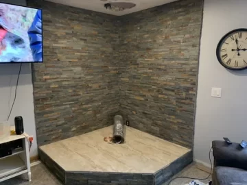

![[Hearth.com] New member - new install [Hearth.com] New member - new install](https://www.hearth.com/talk/data/attachments/271/271625-262f903eec66ba75793714e800430dd5.jpg?hash=07xFLUhmyo)
The installer today told me that since I have a layer of Durock/tile, it reduces the clearance to combustibles in half. So he claimed I could reduce the necessary clearance from 10” on the corners to 5”. Is that correct? I ended up having him leave it at 10” anyway but it didn’t sound right to me.
Also, he claimed that installing my second piece of 5’ exterior chimney was unnecessary and the stove should work fine without it (I currently have a 9’ chimney from the top of the stove and the manual calls for a minimum of 12’).
I have had a small/medium fire going for a few hours and the draft seems okay, but I am considering adding the 5’ section I have anyway to get the minimum chimney height called for. Any thoughts? I wouldn’t mind saving a few hundred dollars on the 5’ pipe but I definitely don’t want to cause any safety issues.
