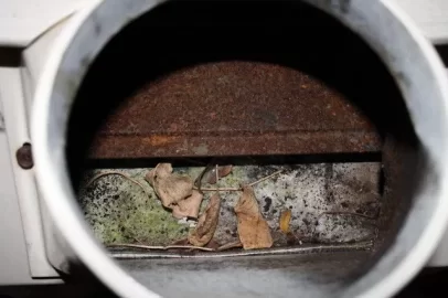

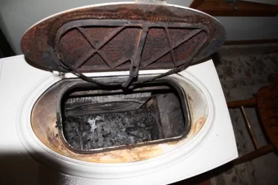

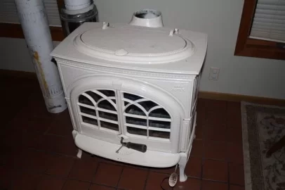

I just bought a Jotul Firelight Model #12 Mfg. June of 1993 for $250.00. It sat out all summer on the previous onwers deck and appears that he had a couple of garbage fires in it. Everything seems to function other than it has a lot of rust scale in it from sitting.
I need some guidance from you all here. I searched posts about my firelight and would like some more info.
1. Does this stove need a catalyst in it? (I don't see anything that makes me think I need to buy one for it. The metal tag on the back that mentions it, but it's vague so I'm unsure)

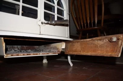

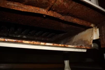

2. I have a lot of rust and scale to clean up inside I'm still searching for a "wood stove tune up" post. (Any pointers)

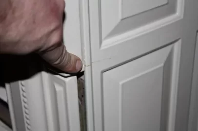

3. I have a small crack on the right side. Can i get this fixed? Do i need to worry about it?
4. Is there any tell tale signs of major abuse from the photos I posted. Warping, etc, etc?
5. Can i buy gaskets and repair stuff from a Menards or should go though dealers buying Jotul branded stuff.
6. I'm attaching pictures of the issues. Please tell me what you think. You donr need to sugar coat it if you think this stove is a dud.
Thanks for all you help

That is a nice stove Tanner, what a shame the fool left it out in the weather. Most of the rust will wirebrush off. Then I would fire it up with a few smaller break in fires. We have a few owners of this stove here, they can help you out for sure. In the meantime, I'll try to answer some of the questions.
1. Does this stove need a catalyst in it? (I don't see anything that makes me think I need to buy one for it. The metal tag on the back that mentions it, but it's vague so I'm unsure) - It should have one. Odds are that it might need replacing, but gently clean and inspect first. If the honeycomb is in good condition then I'd try it. Pages 15-17 of the manual cover this.
There is this wiki which may be helpful. It's a bit of a lecture, but has some good points: https://www.hearth.com/econtent/index.php/wiki/Used_Stove_buying_Primer/
That will need to be watched. It's going to be hard to repair without a scar on the white cast iron. Normal recommendation is to drill a small 3/32" hole at the end of the crack to stop it from spreading.
Eyeball the interior once it's cleaned up. Look for warping or cracks on the interior plates, bottom grate and base.
Yes, but there are variations in density and style, so it would be helpful to get the manual first. Gasket replacement is covered on page 18. It's posted here:
(broken link removed to http://bit.ly/gxsbxI)
It looks in very nice condition other than the rust from the yahoo leaving it outside. The crack is the most obvious flaw so far. If that is the worst of it, give the stove a little love and enjoy. It's a serious heater.

(how would one repair the crack and would there be a way to patch in the missing enamel? I know you can do it on sinks and bathtubs, but would the high temperature of a wood stove make such a "touch up" impossible?)
