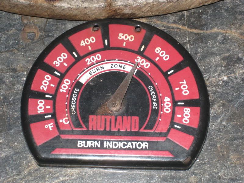

I am almost to 560 or 300c which says "overburn" on the Rutland thermometer.

4. Since I have to return this Rutland, what is the best way to manage temp? Buy a pyrometer and be able to shoot flue and center stone? Get my own Rutland?
Here we are at 11:22, it is coming off of peak which was an honest 300c.
That's a good fire. I actually prefer not to exceed 550 since 600 is the redline according to the owner's manual.

4) Get your own rutland. I have one just like your photo on my stove top center stone. I also have a flue probe meter from condar which I like. You need the stove top meter for sure since you are trying to get max output you will be flirting with the max allowable temps, you need to know. They're like 10$.
