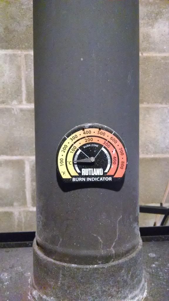

Sounds like you were using a rutland thermometer. Those clowns use a scale that is a compromise between what is recommended for stove top and stove pipe.
Condar does a better job by making a separate stove pipe and stove top meter.
Here's the range for the stove pipe,,,, notice about 475 as the max

You are ever so right The package said that it would go on single wall pipe...... I also remember seeing somewhere that 300 is the minimum for flue temp to avoid creosote.

You are not the first to make an honest attempt at doing things right just to be mislead by a thermometer that gives the operator a false sense of what is happening due to that ridiculous compromise for the "burn zone." The sad thing is the thermometer you are using is found most everywhere, and decent ones usually only found on the internet or at stove shops.

That temp gage is too close to your stove to get accurate flue temps. 18 - 24" away from the stove is the norm.
It's actually better that he had that particular thermometer down low. Had it been up higher, he may have tried to run the stove even hotter!

I just did a little test with my trusty ryobi infrared thermometer, i'm burning normally tonight as its really cold here tonight. 350 degree chimney and a 580 degree stove top. The burn conditions tonight are the same as i always have. When i said earlier not to go over 550 that is on initial startup, it usually sits around 280-320.......
Hadn't thought of that, but very true :)
