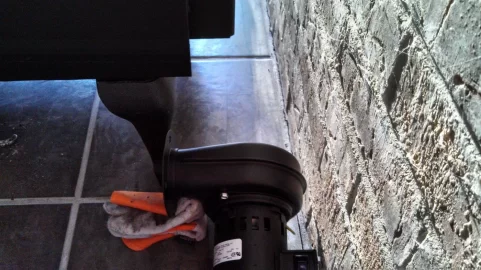

The AC16 blower won't work here. Need to get the 30.

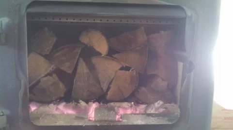

And....a load from early this afternoon......Still burning down the coals from this one. All soft Maple.

Dave, How did that load burn last night? I've never put that much wood wood in a stove before! Wow A load like that of red oak would burn much longer wouldn't it? I know the heat value is different.

I looked at that and thought - I can see where 4 small splits could be inserted....;lol;lol
Those splits aren't real big. That was an afternoon load that I started about 1:00 p.m. before we left for the day.
It kept the house warm into the evening....about 9-ish. Not real cold yesterday.
The Oak would provide more heat for a longer time.....more coals, while the Maple will turn to fine fluffy ash.
I'm still experimenting.(insert mad scientist laugh here).
The more, the merrier. I had noticed that with the coals all up in the front I was wasting space in the back. Thus, now I am putting in two splits E-W in the back giving me a level surface and then I load it up N-S. Totally unscientifically, I would say that extended my burn times at least by half an hour.
P.S. Welding gloves are mandatory for that one, though.

I got to retrain myself, I split wood all last week and those splits would be the biggest I've got. I have always split small for hot fast fires, but feeding this 30 is a whole different concept, it doesn't seem to burn the splits as much as slowly digest them. Makes splitting a lot faster if I don't have to go so small, but no wonder folks take three years to season.

The old stove would have run up to 750 or higher with a load like that. A load like this in the 30 gets up to 650 or so and levels off with a lot of off the wood flame for a couple hours.
Still seems to be a lot of offgassing early in the burn, then a slow decline, but all that takes longer in this stove.
Never put that much wood in ours. Holy smokes my house would be 100F for hours.
Try to close the damper just a little bit more to minimize that, and you should extend your burn times some more. Just keep checking the flue to make sure you're not smoking, and/or dirtying the glass.
A load like this in the 30 gets up to 650 or so and levels off with a lot of off the wood flame for a couple hours. Still seems to be a lot of offgassing early in the burn, then a slow decline, but all that takes longer in this stove.
Yeah, the soft Maple will gas off a bit faster than a load of Oak, etc.
But if it's like our bigleaf maple it will make such cool blue flames and lots of coals.
