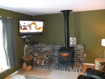

There is some Dbl wall on my 30 and it sets right inside the stove neck like BB said. Congrats - great stove for sure.
Are they delivering to a local HD or to your home? Mine was delivered to my home and for $50.00 the two big fellas that came with the truck helped me get it inside and next to the hearth. Big life saver and worth every penny - they are heavy.
On the other hand, if you have a plan to get it inside having a few break in fires outside will eliminate some of that stink in the house but it was not to bad from my experience.

Thanks for the info. and pic Bob.

30.5ish to the top of the heat shield mounted on the back - 29.25ish to the upper deck but I am sure the specs are to the top of the outlet. This is with the legs - there pedestal is shorter I believe and there are short legs available if I am not mistaken. I wanted all the height I could get to make loading easier and I like the look of the legs vs. pedestal personally.
Note - they are DEEP too and front loading - obviously so in my pic the tile floor was added for ember protection going from a shallow/wide side loader.
Big clean glass - you will love it!!
