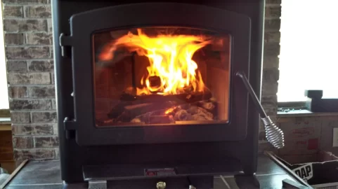

Got the stove in and running to get the paint cured.
I forgot how loud the smoke detector is.
Windows open.
Doublewall is helping to keep the brick much cooler.
Getting some smoke out the door when I slowly opened to add a bit of wood.
Yep, opened the air, then the door....slowly.We don't have any windows that could have been opened, but our lungs filtered out the haze in no time. You opened the air control fully first, before opening the door?

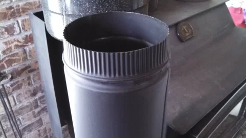

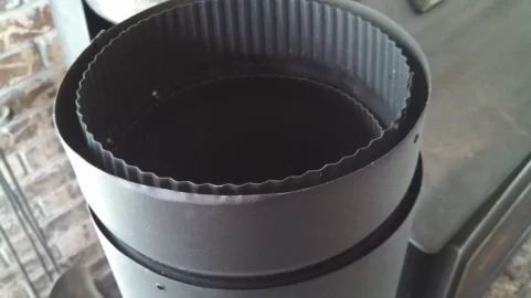

Should have put in doublewall 4 winters ago. No need for sealant on this stuff, since it fits like a glove.
The brick behind this pipe is only about 100°, while the old 1x pipe kept the wall at least 150-160 on a good burn.
I now see why the R value is so high for the hearth too. It's toasty underneath the stove.
