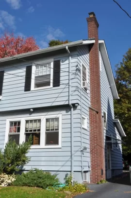

1) Cap - At the top will be a terra cotta cap, sealed and attached to the existing 8x13 clay liner.
2) Sweep - We've had fewer than 10 fires since the clay chimney was last swept. Should it be swept again before the install?
3) SS Liner - I'll be dropping a 6" 316 SS flex liner insulated the full length of ~25'. The inside of the existing clay liner measures ~7.25" wide. Will the 6" with .5" blanket insulation fit easily enough? Any experience with this? Should I ovalize the liner a bit for easier installation?

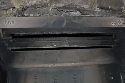

4) Existing Damper - The liner will drop into the fireplace after passing through the existing castiron damper that's built into the masonry of the firebox. I could cut it a bit to let the liner through but would rather keep it intact and not damage any of the infrastructure. I'm planning to ovalize the liner to get it through the damper opening of 4.5" wide. Can anyone see any serious concerns?

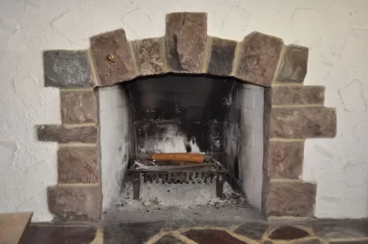

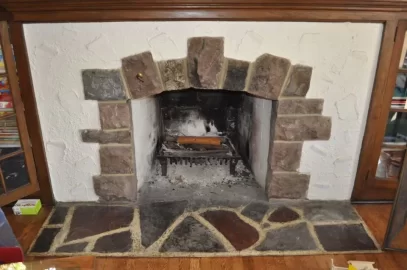

7) Faceplate - The fireplace opening is 34.5" wide by 31" high at the peak of the arch shown in the pics. None of the faceplates are wide enough for the area. Further, the faceplate for the 2200 is designed with a certain angle around the outside square of the plate that would not be terribly good looking if trimmed to the arch I have. Therefore, I was going to build one or have something fabricated. Is it important that the faceplate be a solid sheet and sealed? What if I design something with decorative perforations using this: http://www.decorativeiron.com/produ...=subcategory&category_id=13&subcategory_id=83 ? Any thoughts on copper for the faceplate? Anyone know of a fabricator that has done something for the 2200?
