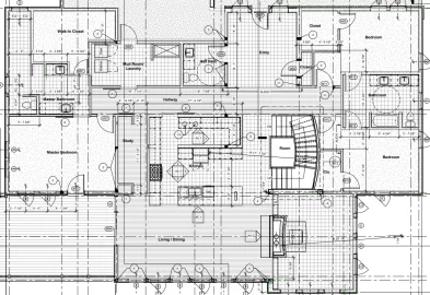

Thanks for the reply. I'm glad the FP30 is working well, and it definitely sounds promising in my application as well. Main floorplan and West elevation attached. Downstairs will be partially finished with a rec room below the living room. This is still a conceptual work in progress and doesn't reflect changes made to the deck location, window configuration, and overall height of the building/walls/ceiling--lessons learned thankfully before starting construction. Open floor plan, with open stairwell, R49 ceiling (no attic planned) and R27+ walls, well sealed with foam and blown fiberglass. Should be a nice tight container with gas furnace, but I want make sure I can efficiently move air around in the summer and winter. The HVAC "pros" weren't a ton of help as a consultant, especially with thinking outside of their realm of expertise in standard installations. I know the high ceilings and open stairwell are a liability; main goal is pushing/pulling air to the bedrooms in the corners without overheating the living room. I've seen it done in a simpler application, using the height of ceiling and well placed fan to move air across the house like water in a canal (only upside down!) form high to low pressure. I was exploring the ducting idea before I discovered the FP30, so it mostly reinforces my belief that it can be done well, but maybe on a smaller scale, assuming heat loss in the duct itself. Perhaps it's best applied when moving air up and downstairs within 20 feet of the fireplace versus any appreciable lateral distance.

Right....our entire house is pretty even heat wise with the fp30. The stove/family room for sure being the warmest. It is usually 4-5°F warmer than the furthest room on the main floor and usually 10° warmer than the basement bedrooms. I run the furnace fan.... mostly because I always have ? My thinking that moving air is moving air???And think it helps with the basement bedrooms. I would say that we must have the "river" effect going on here, but our layout is much different than yours. Somehow in the 1000sqft of basement that is not drywalled but is fully sprayfoamed with the door closed it maintains the same temp as the basement bedrooms?? I attribute this from the furnace fan effect but do not know for sure?? I will take a pic of our floor plan for comparison. Note that we did put up a "curtain" at the bottom of the open stairwell in a attempt to keep the kids basement rooms warmer. Not sure if it works but it makes the DW feel better that we are trying to keep them warmer. 75° stove room and 65° basement is decent in my opinion for 6200sqft of space with high ceilings and probably over glazed with 366 glass.

Sorry about the bad drawings,they were my working set when I was framing the house....
