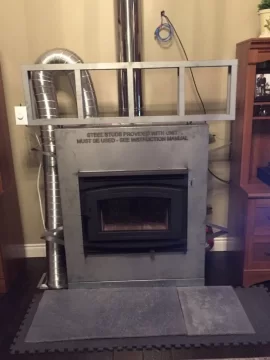

Been lurking here for a few months now and finally pulled the trigger on a Pacific Energy FP30 Arch with a remote vent/blower kit to heat the rec room in the basement below.
It is being installed today and I'll update this thread as the work progresses. The fireplace is being installed now and the stone work will follow in Dec. My stone guy is going to be beefing up the floor joists in the basement by installing a 3 ply 2 x8 beam on posts (cradle), across the span, about 24" out from the back wall, to support the huge weight of stone going up the 18ft wall.

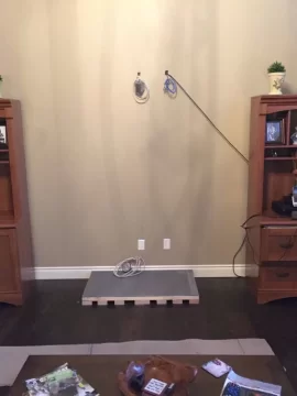

Here is the first photo of the platform it is resting on.
[Hearth.com] New Pacific Energy FP30 Installation Progress Thread

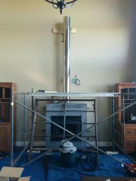

Here's the second with the first section of pipe installed;
Here's the 3rd with another section of pipe:
Looks like it will sit proud in the room.....keep the photos and such coming. It seems difficult to find any threads like this on the fp 30

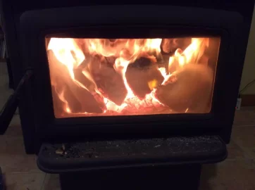

This is a recent pic of a load just taking off. My glass just stays like that in definetly.

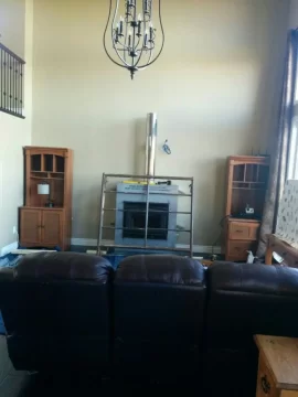

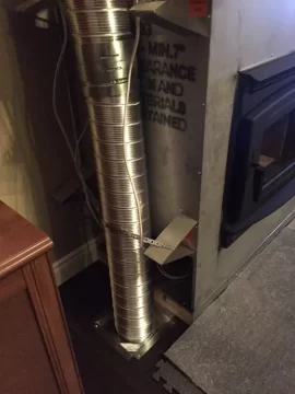

So the inside section of the chimney pipe is now complete. The Outside Air Kit is installed. Today they will be completing the outside section of pipe through the roof and then the remote vent kit down to the basement. Once they are done I'll be wiring up the fan speed controls for both the fireplace and the remote vent kit.
I find it funny that in the PE FP30 manual it recommends adding a switch or fan control to the fireplace blowers but don't include and in the optional remote vent kit a fan speed control is included. I guess its all about keeping costs down.
I'll post more picture once they are done the job later today.

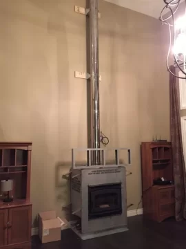

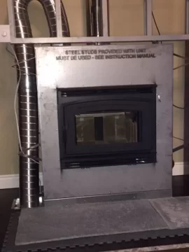

So the installation is complete and is fire ready. We placed a sheet of concrete board in front of the unit temporarily as required so we could could use it. Here are pics of the final work done.
This is with the Remote Duct installed
A bit closer look....

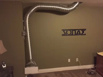

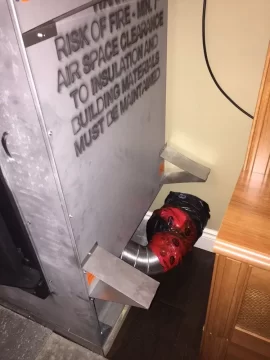

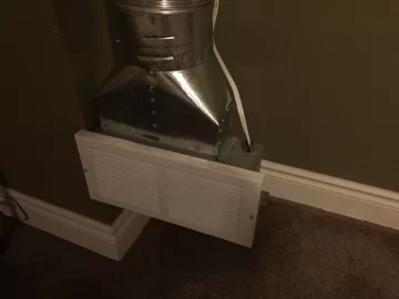

Close up of the ducting going through the floor to the basement...
A close up of the Outside Air duct....

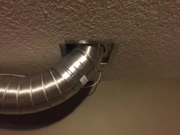

Remote Ducting through the basement ceiling....[Hearth.com] New Pacific Energy FP30 Installation Progress Thread
A view of the whole Remote Vent Kit system (not in its final resting spot as a support beam will be installed across the span to support the weight of the stone going up, and then a bulkhead to enclose the ductwork)...

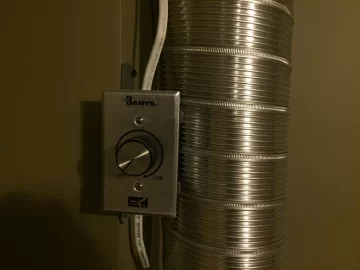

Close up of the rheostat included with the Remote Vent Kit....
Close up of the blower head. I apologize, but I should have taken the picture before putting the cover on, but its just a basic fireplace barrel fan you can pick up at any fireplace store or website installed in a metal casing....

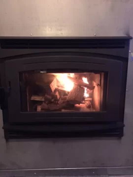

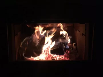

And now the fire shots... :)
Just lit.....
After about 40-50 mins. I added a couple of splits to the kindling coals.....

As a matter of fact after day one of the install I did notice a bit of cold air coming from in and around the air control. However, at that time , the OAK was installed, but the chimney wasn't yet. I attributed it to the outside air coming in with nowhere to go but into the room. I forgot to check it again after they finished. I'll try to remember to check it again when it cools down.

Yes I have been keeping the remote fan running whenever the fireplace is burning. It keeps the basement nice and warm. Once the the FP reaches temp, warm air does blow out nicely. We have a walkout basement with a set of double doors on on end and a single door on the other with a bunch of windows in between so it was a challenge for the oil burner furnace to keep the basement warm because of the thermostat being up on the main floor.

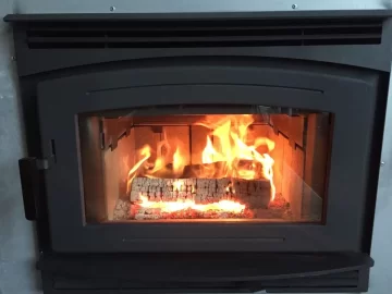

Yup looking forward to the cold weather for a change lol. Wifey got the FP30 going this morning at 7:30 to get ahead of the cold temps coming today.
We've just been loading 2 splits at a time all morning and we're at a comfy 71-72 depending where you are on the main floor.
Here a couple of pics l. The air control was all the way down.

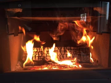

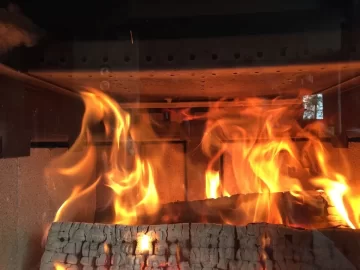

Here's a closeup of inside the firebox.
Here's the whole front of the unit

If that is the same firebox as the summit, which it appears to be. It's meant to be loaded N/S(straight in) for best performance. It'll make it easier to stuff it right full with no worries of wood rolling onto the glass.
Looks great though!
