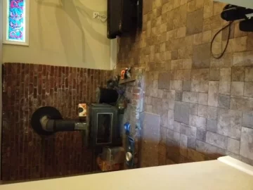

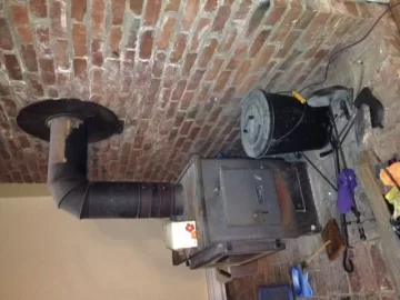

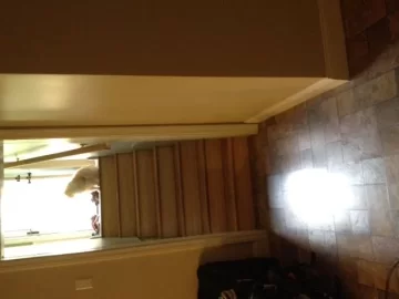

The side with where the pellet stove will go is insulted, but not the same as my addition which is connected. My total finished basement is 16x40, open floor plan. I have 4 windows, sliding glass door, 1 door separating the basement with the laundry area.
The addition side has spray foam insulation, where as the original house (pellet side) has your standard padded insulation.
Attached are some photo's of how it is now...
