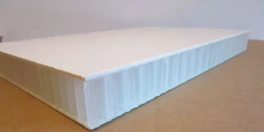

You'd be much better off with a honeycomb air break/gap.
I'd be worried that the honeycomb would melt and leave a sticky, waxy mess on my hearth.
