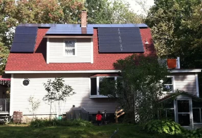

    Had a 6.375kW system installed on my roof. Twenty five American made Suniva 255W panels with Enphase microinverters. Microinverters allow each panel to operate independently of the others to partly counteract shading.
    I expect shading to increase as winter approaches. I predict this will affect the panels lower on the roof more, but the price jump to put those 3 extra panels was not really significant in the big picture. Almost added another row even lower, but I think that would have crossed the point where it would not really be cost effective, particularly when you look at the long term.
    The system is bigger than I need both because I want to get a plug-in hybrid in the future and because MA pays out SRECs for each MW generated. SREC market is at the floor right now, but it is still cost effective, I think.
    Company was very professional and overall did a great job. There were a few delays and set back, but that is to be expected with such a large, complex project, particularly where multiple permits, rebates and other incentives are involved.
    I expect the break even point to be around 7-8 years.

    Nice going. Keep us posted on how it performs over the seasons and how well the Enphase units stand up.

    Nice system Vic. Neat set up and I will also be curious to see how the micro inverters work with the different pitches on your roof....looks like it will work well in all conditions...some peak output in the summer with the less angled panel on your dormer and good year round output with the steeper pitch arrays.
    I may send you a PM to ask some details and perhaps cost as I am only a little west of you.
    Please keep us posted on how it performs.

    We went through several design schemes before settling on the final. My roof pitches are acceptable, but far from ideal. They just about face true south, though, which is perfect. Shade analysis got me at 82% of full sun. The state wants 80%+ to qualify for a rebate.
    Started looking into solar seriously in March. Got 3 companies to come out and take a look. Only went live late Friday.
    PM if you get serious.

    Looks good, plan on buying a roof rake. The enphases help with partial shading caused by snow sliding down and blocking the base of the panel but sometimes the snow is just right where the panels are covered and it can take days for the snow to melt off. A plastic roof rake usually speeds things up quickly to get back in production.
    BTW, most plans figure in inverter replacements every 10 years. As the inverter change so often who know how long newer designs will last.
