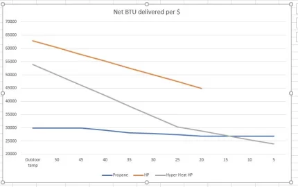

Question 1 - Is hyper heat worth it?
I did some math with calculating the BTU delivered per dollar delivered over various heat ranges from my condensing boiler, the hyper heat and the standard heat pump. The thing is, while the hyper heat will heat well below our design temp of 8F, its COP drops off much steeper than the standard unit. Based on my numbers it looks like its probably far more cost effective to just buy the basic unit which can heat down to 14F, and switch to propane whenever the temp drops under 20F or so - which around here means basically just overnights in Jan/Feb.

So the Veismann, while efficient is running on propane . The first floor AC is on its last legs (vintage '93) and the great Commonwealth offers a lot of incentives to put in heat pumps. So you know where this is going... I got 2 proposals to replace our first floor SEER10 ducted 2.5ton AC with a central heat pump.
- Vendor A proposes 19k before rebates to put in a Mitsu hyper heat light commercial (PUZ-HA36NHA5) - 3ton SEER 17/HPSF11
- Vendor B proposes 9.8k before rebates to put in a Mitsu SUZ-KA30NA - 2.5ton SEER 18/HPSF13.4

- my price of propane averages $2.90 a gallon and the boiler eff ranges 88-95%
- my price of electricity is 23c/kWh all up
- the Hyper heat option has a COP of [email protected] going down to [email protected] but it can heat to -5
- the standard heat pump has a COP of [email protected] and [email protected] It can only heat down to 14F
- Our design temp around here is 8F afaik
