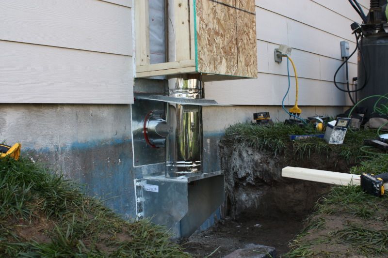

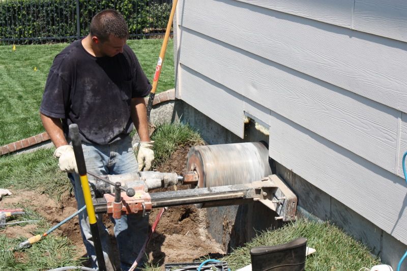

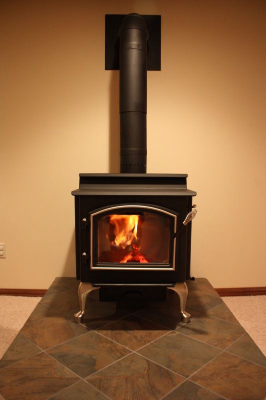

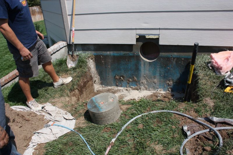

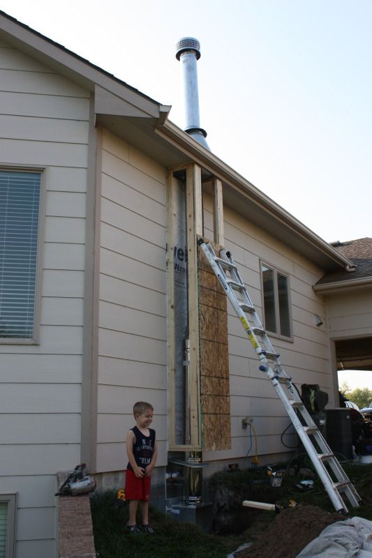

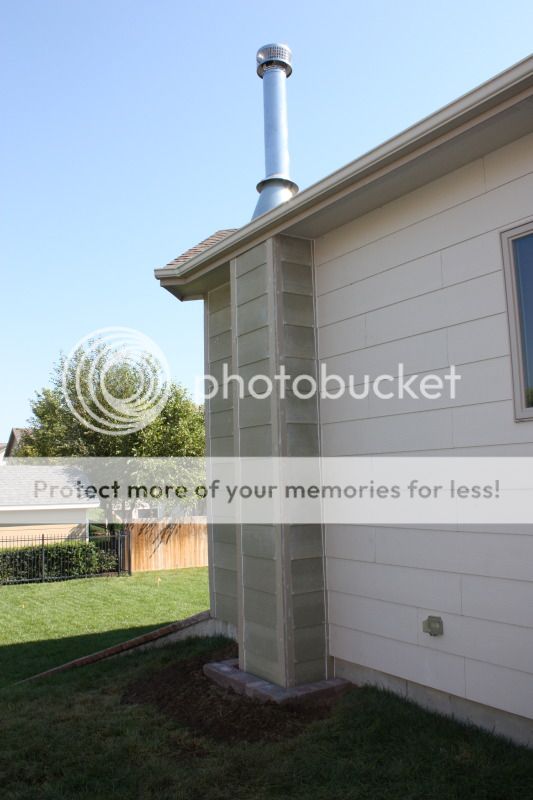

Breakin went well. I ended up slowly getting it up to temp and burned all day. Smell wasn't as bad as I figured it would be but had windows open and fans running. Here's some install pics. Also, note to self, don't throw a 14" pallet pine 4x4 on hot coal bed!

Very impressive install. Handsome son, too. The stove is perfect for that room, and very attractive.
Happy burning, and welcome to the Forum.
Thanks. I got the outside painted and there's also been a roof brace added. Now I just need to get some trim installed on the hearth and it will be complete.
Great job! Congrats on the new stove.

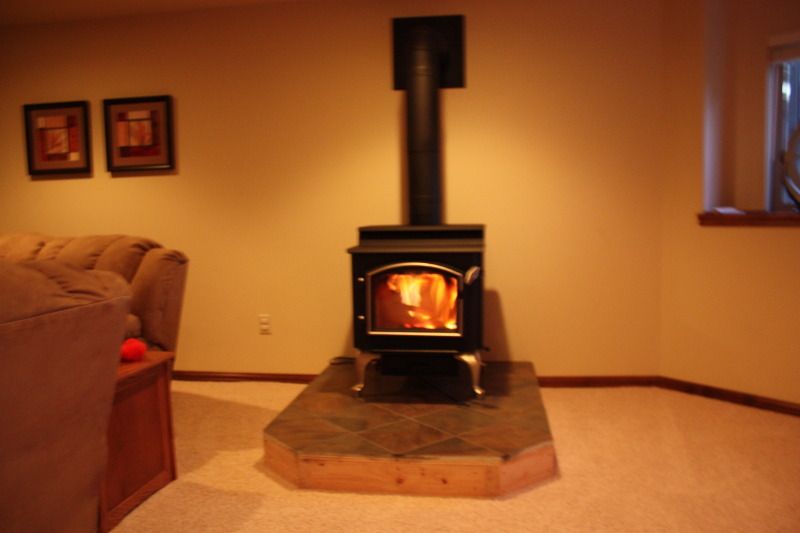

I originally wanted the PE Summit too but it was just going to cost too much around here. I got a much better deal on the Quad. I was leaning towards the pedestal and just getting started as cheap as I could but wife liked this setup the best so I had to make her happy. Sure was a tough pill to swallow for those legs :eek: . Our house has a modern look to it so this really fits in well I think, although there are other stoves that would fit in even better but I don't think you could cook on them if one needed to. I wanted a more elaborate hearth but there was really only one place to put anything in the basement and this was it, and it had to be an outside chimney. I had to compromise a lot regarding my true tastes and wants but ultimately achieved the true goal.
The hearth pad is 4'x5' and is 2x6s on end with 3/4" plywood on top and 1/2" backer board on top of that and then tile.
