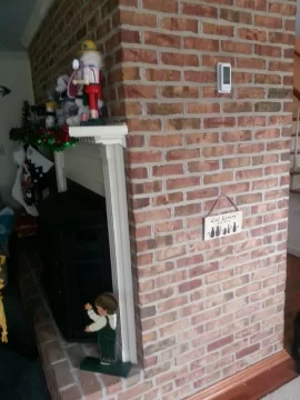

Here is my setup.
-vrf201 (Roy)

Beautiful! Hope the stove gives you years of trouble free inexpensive heat!!

Is your thermostat wireless? Mine is wired, I thought the only option. It's mounted on ever side of the mantle.
Yes, the E2 switched to a wireless t-stat.
