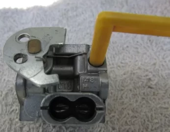

So I finally got all the parts that were either messed up or missing which included bumper (bucking) spikes, new clutch/brake cover and new chain. I also bought the carb tool.
I had the saw running before w/ no chain (old chain was damaged) and it was all over the place, idle normal then start revving all by itself, stalling, bogging...all w/ no chain so no load.
Put new chain on and everything together and tried again, same stuff. Oil and unburnt fuel dripping all over exhaust.
Took the adjusting tool to the low and high sides to seat them and then wanted to back them off 2 turns each as a starting point. The low side was 6 1/2 turns out! High side not much better. Turn them out 2 turns and start the saw. It's idling way too high. Turn the idle adjust counter clockwise to lower idle, saw starts revving higher?? Turn back saw slows?? Only way to get idle down is to turn fully clockwise. Try messing w/ L and H to get something near right but still saw has a mind of its own, revving, slowing, bogging with throttle, not bogging w/ throttle. Go to bed confused, thinking air leak??
This am try again. This time I pop the cover and look at carb as I turn idle screw counter clock wise. Throttle closing like I expected, hmm. Before starting I back the idle screw almost all the way out and put the L and H screws 1 1/2 2 turns out. Start the saw runs OK. Set the L side and adjust idle couple times. Get the H side adjusted while cutting trying to get 4 stroke sound. Not perfect yet (I'm new to this) but saw is running much better and I can adjust idle screw and it holds idle where before it doing whatever it wanted.
Long post I know ;em but there's a point. Saw to me was way out of adjustment. L side set super rich which I guess explains oil/fuel from muffler and idle screwed down all the way to get it to run.
What I can't figure is how I was able to give it any throttle before (with the trigger) and rev the saw if idle screw was set to wide open throttle. Have to look at how that works again but its raining hard and the saw is pretty happy so I don't feel like messing with it again right now. Any thoughts on how that could be? I looked on the Zama site and they recommend the throttle adjustment be set all the way in as a starting point?? Am I doing something wrong here?
I assume you're working from this....http://www.zamacarb.com/tipspage.html
Idle screw / TAS is tapered. CW (in) revs engine higher. Observe how the throttle plate moves more open by being pushed by fatter part of taper as screw moves inward = increased engine idle. CCW decreases engine idle - thinner part of taper.

Thanks Doug that explanation helps and you got it, that's the Zama page I saw. I noticed it was not your typical idle adjuster screw but need to look again. Funny how a racing engine takes your focus away.
I'm guessing even with the TAS all the way in, there must still be some travel left in the throttle? Still puzzled but I suppose once I leaned it out by turning in the L side adjustment screw to a normal position the TAS began functioning as it should but being set wide open, it caused it to race. Also explains why when I first was running the saw any time it began to run out of gas, the lean condition caused racing too. Was going through a lot of fuel and blowing a ton of oily smoke with the L side 4-5 turns too rich.
Hope I'm right and it's not a faulty carb but it's running decently now. Need to do some cutting and see.
Sure, lots of throttle left even with Idle screw all the way in. Idle screw diameter is only ~1/8" = all you can alter idle. Total throttle plate movement is maybe 5/8" - 3/4" inch. A digital tach is a good tuning tool. You can get them on ebay for ~$12. Here is one I had on a 2 cyl garden tractor and switched it to 1 cyl for small 2 strokes. I think it will switch to 4 cyl, too.
