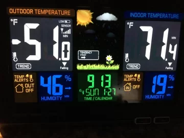

[Hearth.com] New record Coldest day with the new woodstove! I think it works.
I think your weather station is busted!!
WOW!
Amazing! Part of the amazement is the 120+ degree higher temperature inside. How do vehicles start in that kind of weather... is some kind of engine block heater necessary?

Nice! Which stove you have and how much space you heating?

Block heater or better yet in the garage! My truck has started at -30 without but much easier on it if it’s plugged in. Running ashford 30, heating little over 1700ft.
Time for a humidifier

19% is far beyond unhealthy for you, and any wood in your home, among other things. If the % or humidity is kept below 50%, even if you can get it to 30-35%, there should be no condensation problems, or there is other issues at play.
Below 50%, 19% is ridiculous. To each their own. Enjoy the shocks & sore throats.

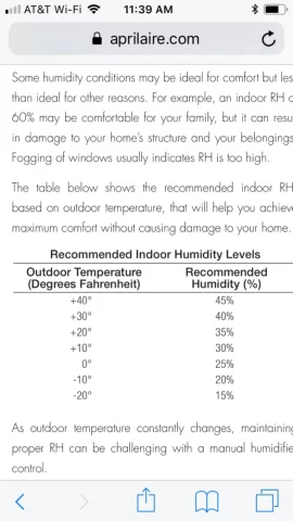

[Hearth.com] New record So you disagree with everything I can find?

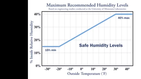

View attachment 239325 So you disagree with everything I can find?
Yes, when a person is walking around getting shocked by everything they touch, waking up with a sore throat every day, wood inside the structure cracking, and prolonged illnesses. If your skin is drying out and flaking . All signs that you're living in an unhealthy environment of too low humidity. Try looking at what low humidity level does to your lungs and body.
If you are comfortable, and don't have those issues, then you may be right.
All In know is, at teens & single digits here, the place and myself dry out very badly. Took me 3 weeks to get rid of a cold, lingered on. Fire up the humidifier, was coughing less violently, and cold was gone in a few days.
I'll give you, that I don't experience -50% temps. Maybe -20 wind chill rarely, but not what you get.
Don't you get dried out?
Thinking about this, and the different situations, I will accept that you are right, for your conditions.
Admittedly, I can only speak for my area, temps, and house. I know the minute my hair is sticking to the side of my face, and everything I touch shocks the hell out of me, I have to fire up the humidifier.
So, you don't get dried out? No sore throats, shocks, static cling etc?
What about furniture and wood in your place, does it crack due to the low moisture content?
I learned something new today. So even if I made myself look like and ass, I still gained some knowledge. Thanks
Shock once in a while yes. But really no other problems. I would like to have a little higher humidity but keep it this low to prevent other problems later. Just going outside with this dry cold weather isn’t good but what can you do this is where we choose to live.
