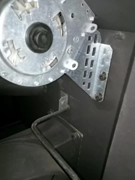

Wherenexactly ois it located? I need a picture or something/Thank you both for the help. I called customer service today. They advised me to adjust the airflow gate and also the blower and exhaust voltage. So far so good.
