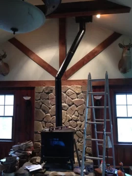

The people we had install the old stove ran the pipe up 3 lengths then a 45, 1 piece, another 45 then into the box they installed through the roof. I couldn't get a brush down thru the 45s to clean it. I'm trying to soften up the bends with 22s somehow for ease of cleaning without removing the whole thing, taking it outside to clean then reinstall it. I'm mocking it up with brand new single wall, didn't want to re-use the old single wall since its a new stove ( even though its only 3 yrs old). Aesthetically the new configuration might not be as appealing, but it appeals to me to be able to clean the darned thing throughout the winter. One chimney fire was one too many for this guy! Feel free to comment if you think this is not the best idea as I'm still a rookie
She's almost ready. Pipe mocked up, just have to screw it together and caulk the joints. Anyone see any issues here? Other than the clean-up that is. Hearth dimensions are 48" deep x 60" wide, stone back is 6+ ft high with concrete board behind and under the stone hearth. 11" is the closest it gets to the wall right at the top bend and short up-pipe. I will shoot that with a digital thermostat and do a heat shield there if necessary. Might do the initial burn tomorrow if I have time, busy day planned. Sorry for the big picture, wanted all the details shown before I burn my house down haha! BTW thats the same spot I used the old Federal for the last 3 yrs
[Hearth.com] New stove advice
Picture is taken off center to the right so the pipe is pretty plumb according to the 2' level
With the long run of single-wall connector there is going to be significant heat dispersal. The long run and elbows are going to decrease flue temps and increase draft resistance. Keep a close eye on creosote build up.
The old configuration that the "pros" did was 3 straight pieces, a 45, 1 more straight piece then another 45 into the box. Couldn't get a brush down it to clean, and it did have alot of creosote. I'm hoping this one burns better and with the angles not as steep maybe I can run the brush down the pipe without removing it, taking it outside then apart to clean, and re-install. I guess I will see soon enough. Thanks for the reply, begreen!

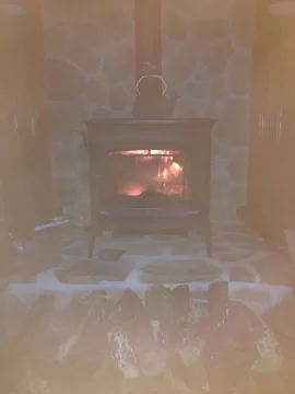

[Hearth.com] New stove advice OK folks, I have spent a few days with this beast and I'm very satisfied. It cruises no problem around 400* give or take, something I couldn't get my old stove to do. It heats back into the other side of the house enough ( raised ranch, upper floor) but not too hot as so we can't sleep comfortably. I'd say when its cooking at 400 its Africa hot in our family room, so the 2 ceiling fans on medium for now keep it bearable. I also have a 12" circular fan in the next room blowing cooler air into the room where the stove is. Its been down in the 30s here the last few nights and I could sleep in shorts with no blanket in the family room ( I did fall asleep on the couch watching the World Series haha!)

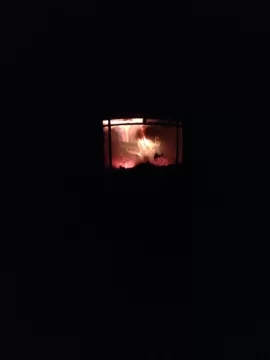

The one question I have for Manchester owners is why the ash doesn't get into the ash pan? I have roughly a 2-3 inch bed of hot coals and I've been burning for several days and have yet to get much accumulation in the ash pan? It does make for an easy time getting the fire going when I get up for work at 5am however. I took a pic of the secondaries firing nicely this morning in the dark about 5 min after adding 2 fresh pieces of wood I will try to post. Overall so far this stove gets 2 thumbs up!! I can't wait to see how well it does with temps steady sub-30s
