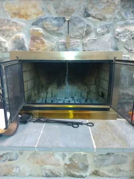

Hi everyone. I've been watching this forum for a bit now, and would like to learn from those more experienced.
Since I'm looking into installing a wood stove or insert, I went to a local hearth shop in Southern Maryland but all I received were a bunch of brochures and no specific advice.
I would like to install a wood stove or insert in the existing fireplace. The house is about 2350sqft, single story floor and located over a crawlspace in the bottom.
The fireplace is dead in the middle of the house as seen in the pictures I am providing. I would like to have long burns to not be reloading every few hours, as well as the option for occasional burns with the door open (using a screen ? ) since the wife will miss the open fireplace. Being a crawlspace house, I don't think the stove can be the primary heat, since I don't want the water pipes freezing I would need to use the furnace a few hours during the day. The crawlspace is sealed and encapsulated though.
The room where the fireplace is located has vaulted ceilings and two massive skylights that go to the rooftop, so the volume of space to heat is more than if all the 2350sqft were 8 or 9ft ceilings. We also spend most of our awake time in the common areas and have no need to heat the bathrooms or closets in the ends of the home. The playroom area has sliding doors which I currently close the few times I use the fireplace so that the little heat it gives off stays contained, so I imagine I would do the same with the Insert during nighttime burns.
What would give out more heat, a properly sized insert or a smaller freestanding woodstove that would fit inside the firebox?
For sizing, should I go with the recommended sqft from the manufacturer or the BTU output? And how accurate are those sizing specs?
Would you recommend catalytic or non catalytic stove? Steel or Cast Iron?
I read about the BlazeKing Princess insert, but i don't think it would fit properly while meeting the clearance requirements (see firebox measurements diagram).
Any feedback and recommendations are welcome!

I'd put in the largest insert that fits.
If you want to burn with the doors open, don't take a cat stove.
Reactions: Jedi
Can you satisfy the ambience requirement with a unit that has a large window? You'll see flames and there will be radiant heat from the front of the unit just like an open fireplace.
In fact, most modern stoves need the door closed to burn properly.
I concur to get the biggest insert that fits with the biggest window.
My wife Originally from NYC, "had to have" the open fireplace. Well sorry but i already had jotul 3 installed. She "thought" from movies, tv shows or whatever that it's open fireplace or nothing. I don't even think she knew what a woodstove was. It only took about a few days of cold winter weather for her to do a complete 180. She loves the woodstove with the glass door closed because it's hotter! She's always cold but in the woodstove room it is usually 80F plus. I never heard another word about a fire in a fireplace, or can we open the door when it's burning. I'd wager you would have a similar experience.
Large glass door on the woodstove is the way to go.
Osburn inserts have a firescreen option. The Osburn 3500 is a good large insert. It looks like it has a firescreen option, part # AC01281.

My story is exactly as "bigealta" said. My Oslo can run with the front door open. We bought the screen for it, never used. The rolling ball of fire in the stove is much more impressive than a open fireplace.
Your open floor plan / great room will be perfect for a stove. They give of a lot of concentrated heat so a big room makes it less intense. A ceiling fan helps a lot.
As to the stove or insert, I'm no expert here, I'm a stove boy, but......... There are almost the same. The insert is built for your situation, sits in the fireplace opening. Most if not all use blowers to get the heat off the outer surface of the insert. Complaints are, they can be noisey. Are they any less heat than a stove, maybe. So check yours out before you purchase.
As to a stove, some here have built out the fireplace hearth to allow a full wood stove to sit in front. Some how making the chimney connection work. Others that have done this can explain. Benefit is normally no fan.
But in both cases you need something figured out about the chimney. Is yours a full masonry chimney, that a insert fits into?

Id go with the largest insert. Having the fireplace not on the outside wall is a plus. I wouldn't do a free standing stove with your setup. You will get plenty of fire viewing with an insert with a large window, you will not miss the open fireplace. I wouldn't plan on burning with the doors open, we have this option and have never done it. You can cut your usage of heating usage to 0%if you choose to, all this depends on you and how you want to do it.

Unfortunately the with Montlake sticking out 8in from the firebox, I would only have 12in of hearth left. Being a raised hearth about 12 above the normal floor, are there exceptions to the 16in requirements?
